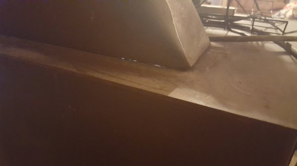

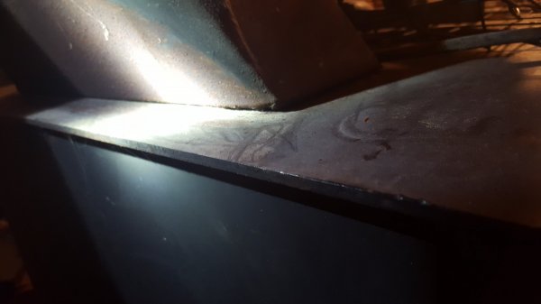

    It was hard to get a pic showing the "crack" at the seam. You can see the light easier looking up into the stove, but the phone wouldn't capture it.

    That doesn't look to bad at all. Pull the boot lay down a bed of cement and bolt it back in place. It should hold up for a while. I would prefer gasket because it will fix it for many years. But that crack is pretty tight. Cement should work ok

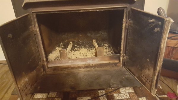

    Should there be gaskets all around the doors? Right now there is only the one piece on the right door, on the edge that overlaps the left door. Against the lip, where the doors meet the stove, it kinda looks like there is some residue, like maybe gaskets were there at one time.

    If it seals well without gasket no it doesn't need it. If it doesn't you need to add gasket. It really doesn't look like there was gasket because I don't see a chanel for it. But that doesn't mean it couldn't benifit from some

    Also are those andirons part of the stove or loose? If loose take them out this is a stove not a fireplace.

    Checked the doors earlier with a piece of paper. Surprisingly a couple spots were tight. The bottom wouldnt have held a stack of dollar bills, so gotta do something.

    That tells me your doors are warped. To me that makes it scrap

    I'm not saying that they aren't, but... the piece of gasket that is on the door lip that overlaps the other door ...I'm thinking this might throw it off a bit. And what I've read on the bucks, there is a different gasket on the bottom than what goes on the sides and top.

    That is certainly possible. Pull the doors off to see if they are flat
