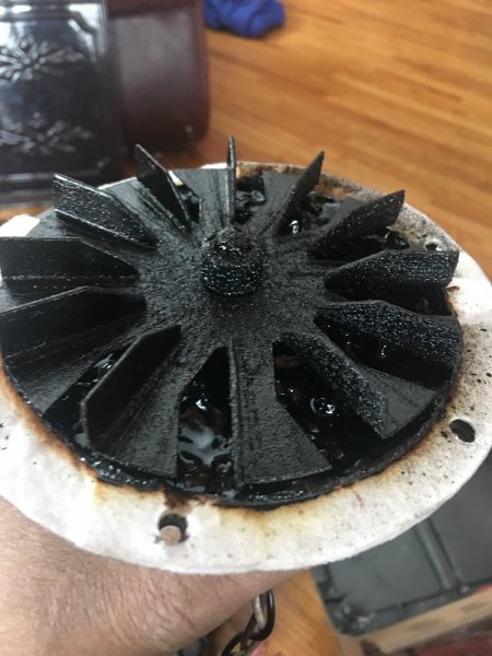

    This one bag of pellets created a lot of creosote in this St Croix Hastings since the last time it was cleaned!!
    See pic of exhaust blower!
    After cleaning the stove again and using new different pellets and a new exhaust blower it seemed better but after an hour the pellets built up, the flame was a little lazy still!!
    Finally found the cleanout cover behind the ash pan. Stuck a brush in there and some more hard black chips of creosote came out and all of a sudden we felt the cold air from outside! Bingo the stove works fine and the flame is dancing again!
    Has anyone seen such shiny black creasote and the hidden cleanout behind the ash pan on these old St Croix Pellet Stoves??
    Could it be that the wood pellets had tree bark with creasote mixed in???

    Holy crap is that creosote caked onto that fan?
    :eek:

    Looks like it.:eek:

    Yes, and the fan was nice and clean before those cheap pellets from the variety store were burned!! :hair:

    I think that stove was run for a long time with a vaccum leak... loose ash pan door or versa-grate cleanup rod pulled out. I had that happen right after I installed my stove... but one service call and some directions from the service tech fixed that. He also taught me the leaf blower trick.
