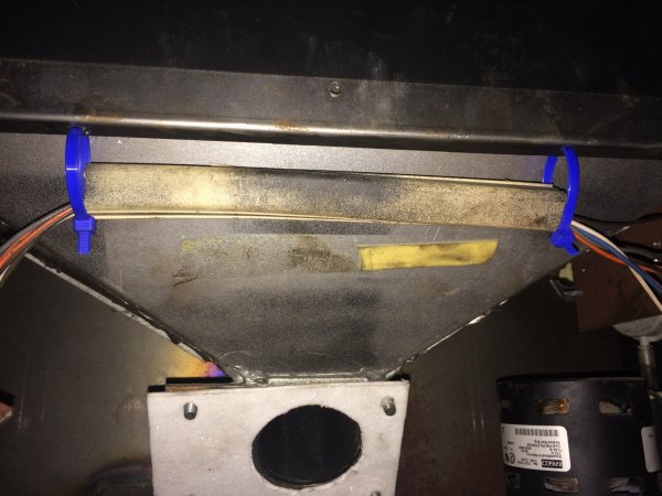

    How does this look?
    Alot easier now to remove the auger motor with a socket wrench and wires stay up away from dangerous hot exhaust! ! !

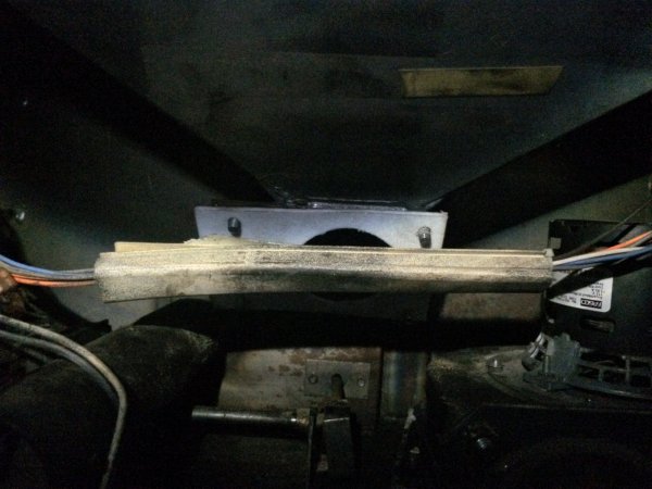

    Pic 1 - Droopy Wires
    Pic 2 - Droopy Wires fixed with 2 blue wire ties into 2 new holes in stove flange.

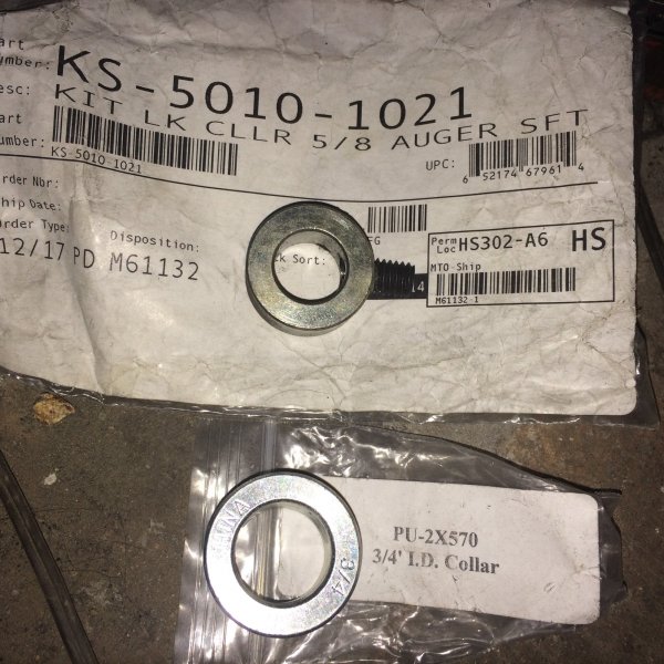

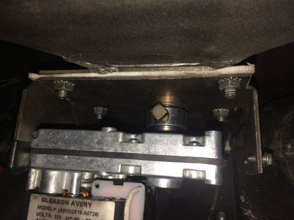

    Pic 3 - New auger collar and set bolt
    Pic 4 - Part numbers of Pelpro 5/8" collar and englander collar with nice set bolt that fits Pelpro 5/8" collar!
