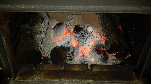

    This is what I found when I opened the stove this AM after 13 hours. It wasn't a full load either. Stove top at 550 for the duration.
    The picture doesn't do it justice...the pieces on the side havent really burned yet.
    wildwest, milleo, fox9988 and 2 others like this.
  14. WeldrDave
    10,207
    56,308
    Yup! it's working well! :cool: Simple works!
    wildwest likes this.
