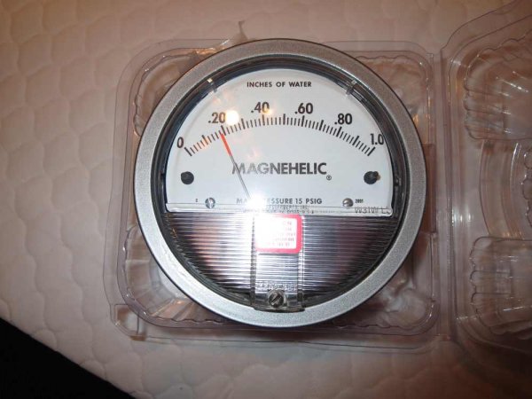

    Ok I think I see where are wires are getting crossed. I said was getting a much higher reading in low draft mode and if memory serves the high draft was pinned on my Magnehelic which goes from 0 to 1.0 . I also noted the manual you pointed out is not the same manual that came with my stove but page 21 of your link is about the same as page 17 on my physical except for the pic showing a measuring Tee. I have a Draft Meter bolt behind the left front leg.
    Anyway my manual states: If the low draft is between -.35 and -.45 record the reading . If the reading is higher , slowly turn the set screw counter clockwise until the draft lowers. If the reading is lower turn the set screw counter clockwise until the draft increases.
    So what I read there is to set the low draft measurement between -.35 and -.45. Am I not interpreting the manual correctly?
    I know the manuals are not always clear or tell the whole story. For instance page 17 of your manual states a Magnehelic which can measure 0 to 1 inches of water should be used. On page 21 it shows a Magnehelic with a range of 0 to 0.5.
    here is my mag (wasn't cheap)...
