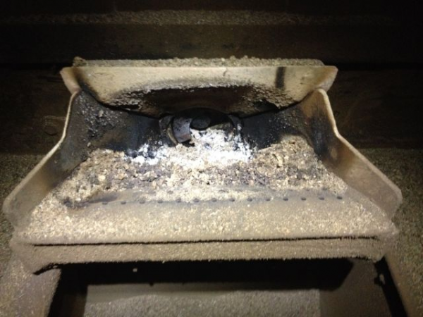

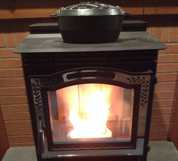

    Burned the first bag of golds last night. The stove was thoroughly cleaned beforehand. Lit at 8:30pm and shut it down at 7:30am this morning. At that time, there was about ~5lbs of pellets remaining in the hopper. Here are some pictures.
    While burning:
    Hopper this morning:
    Picture of inside of stove after burning:
    A closer picture of the burn pot:
    Spock and IHATEPROPANE like this.

    How does this compare to other high end pellets that you have burned in the past? seems like you have platinum and DF?

    Thanks for posting your first results tdburg. Any clinkers in the ash? I am also curious what you think of them.

    That ash looks like a pretty good burn..
    I'm guessing the heat was pretty good? Was the stove running the entire night? Or did it start and stop as needed?

    Tough to compare because it's so early in the season. The only pellets I have burned so far are these, Minute Man, Ligs, and I just threw in a bag of MWP tonight. After I get a bit more burn time, I will be able to do a proper comparison.
    No, I did not get any nuggets like you experienced. I did have a decent size speed bump in the burn pot when I cleaned it out tonight though. I've come to expect that with softwoods, especially pines. A good scrape with the Harman tool easily breaks it up.
    It was 30 here this morning, so the stove ran a good solid burn all night, no stopping and starting. It was on 3.5 for both feed rate and temp (room temp mode). I'm fine with the ash because it's super light and doesn't remain in the pot, so the air flow is not adversely affected - it was burning just as strong this morning as when I went to bed, no scraping needed. The jury is still out on the heat output. Need more burn time to know for sure. I will say that the stove temp was hovering between 350 and 400 each time I checked it. When the hopper was completely depleted tonight, I threw in a bag of MWPs, and within 15 minutes the stove was up to 425. Was not expecting that.

    Agree with Dex, that doesn't look bad and no nuggets either. I am going to dig down in the pile and burn through some bags from another ton.

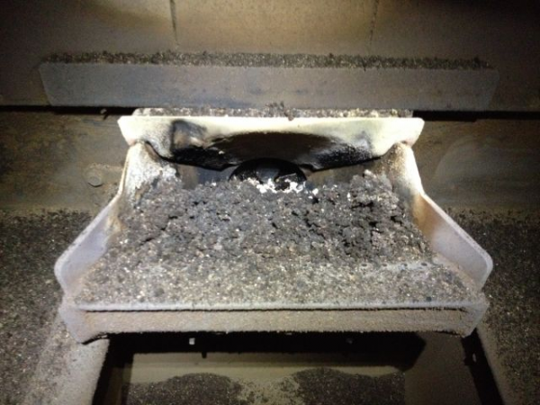

    For comparison purposes, here is what the stove looks like after a night of burning MWPs. It wasn't quite so cold last night, it only got down to 39 here, so the stove didn't have to work as hard. There's probably ~10lbs of pellets left in the hopper. For me, this is a lot of ash, and the flame was definitely burning lazy this morning because of it. Will have to wait for some real cold weather to continue the tests and see how they do with a good strong burn all night.
    eatonpcat, DexterDay and Spock like this.

    so, seemingly there is more ash with the MWP, correct? I think the analysis of the product versus the Okie gold would bear that out. As for the "clinkers", I don't think the original ones were that bad, and, as per the Harman cleaning instructions, they should be broken up when you do your burn pot scraping anyways, correct? I believe your owners' manual will tell you Daily or, depending on the type of pellet, every 3-5 days. Frankly, I don't see an issue with the OP's clinkers if you follow the proscribed directions given by Harman. I should say though, in the interests of full disclosure, that I do sell Okie gold as one of my brands.
