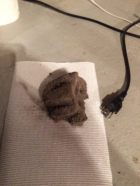

    This Monday I did a one ton/one month cleaning of the stove and then started with the Oakies. My cleaning included verifying that the burn pot was totally empty by sticking my hand in there. I did that again today, after 5-6 bags, and this is what I found after not cleaning the pot out since Wednesday. The auger and everything else were cleaned, I carefully calibrated the pellet feed for the new pellets, & etc.
    Is anyone else seeing anything this bad? My PrestoLog clinkers had only a small number of small clinkers. Nothing else has changed with the stove except the cleaning and making sure the flame height (via the feed setting) is right.

    Was your one ton/month cleaning only of the burnpot? Did you pull anything else apart to clean...ash traps, blower, vent, etc.? Part of that "could" be the stove not "breathing" properly.

    That looks more ash cake than clinker. Which would be more an indication of ash not getting blown out of the burn pot. is it hard?

    Difficult to say. It's kind of sturdy, but I think if I applied torsion or a hammer it might easily crumble.
    Could the stove not be firing long enough? It's on a thermostat, although the cycle length was at .4 (what that means I don't know, it's not the swing I don't think. I just upped it to .8 today to see if that makes any difference. This is the thermostat that came with the stove.

    IMO...it's possibly air flow (lack of) or pellet or both. Typically you do a full and what I would consider end-of-season cleaning after burning a ton to ton and a half. That being said, we have a few posters that had similar issues with the Gold's as yours.
    Does your stove cycle a lot?
