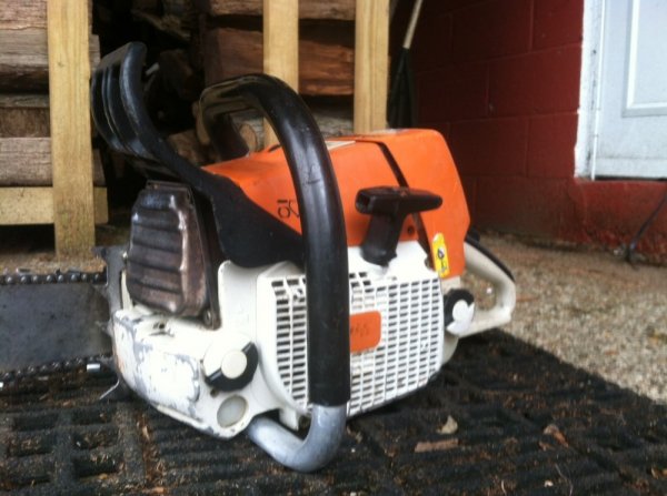

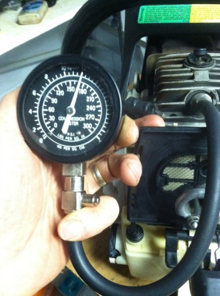

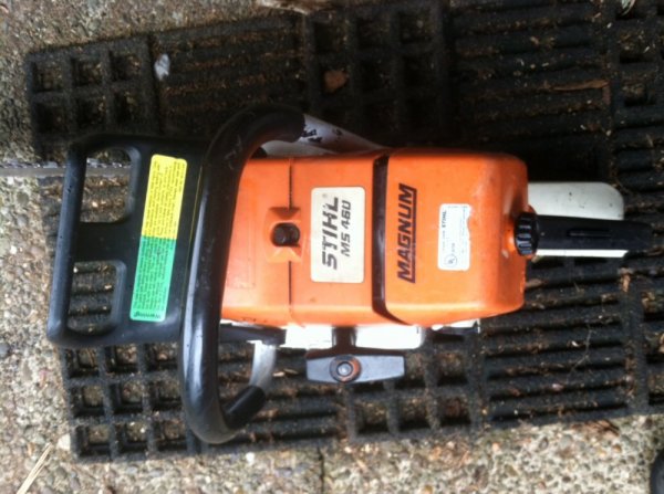

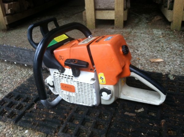

    I'm checking another model off my list of coveted saws I need to try. I bought this saw as a box of parts last fall, and just finished putting it together today. What the previous owner thought was a broken connecting rod turned out to only be a shattered piston skirt. The worm gear for the oiler was shot and the clutch showed signs of having gotten a little warm, so my guess is that he just kept cutting after the oiler quit and the chain tightened up, and that put the extra stress on the engine that triggered the failure.
    Thankfully the cylinder was still in fine shape. After removing a few chunks of piston from the crankcase I pulled the seals and rinsed about half a gallon of gas through the bearings while rotating the crank to rinse out any remaining particles of stray aluminum. Everything felt tight and smooth, so it got new seals, piston and base gasket. Passed the vac & pressure tests, so the rest of the parts followed, with a new chain catcher and spark plug boot. I was able to try it out on a blown-down cherry trunk at the end of my street, just before the rain hit.

    How stock is that muffler? I've said it before, dual-port swap is almost mandatory on a 460.

    It's totally stock, and the front is a bit mashed in so it could stand replacement anyhow.
