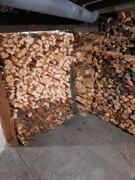

    My sons and I have already loaded about a chord into the basement, and will be putting more in later.

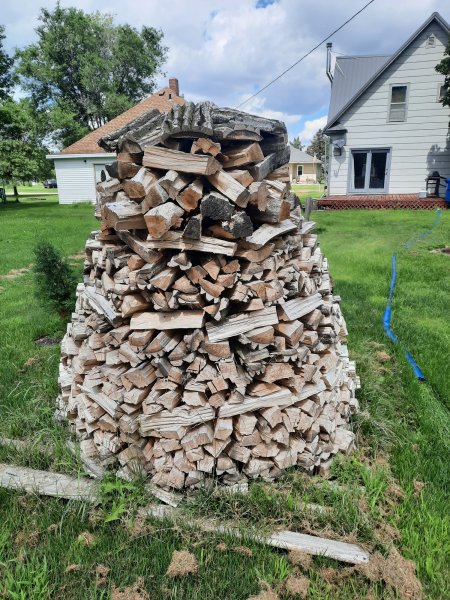

    Here's what I have ready to go for this year so far.

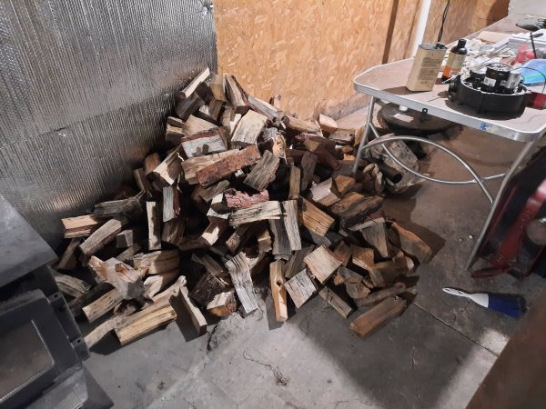

    My ugly pine stack, this will be burned first.
    20200915_222017.jpg A pile of unstackable pine. I dont know who did it, but someone bucked this stuff to only 5-8 inches long, making it unstackable. I picked it up from the city rubble site. You can see how short they are. 20200915_222030.jpg

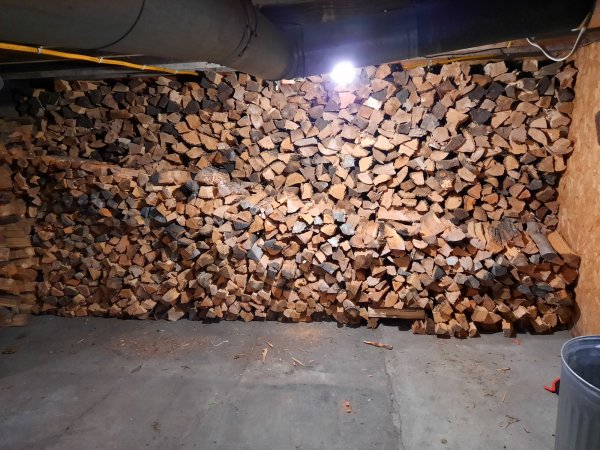

    And now my beautiful stack of hardwoods!! This pile isn't done yet. I need more. 20200915_221956.jpg
    Tell me what you think! Should I be doing something different??

    Judging by the size of a lot of those splits, you could be burning them a lot faster than needed. In other words, let your splits be larger. :handshake:

    Impressive stacks.
