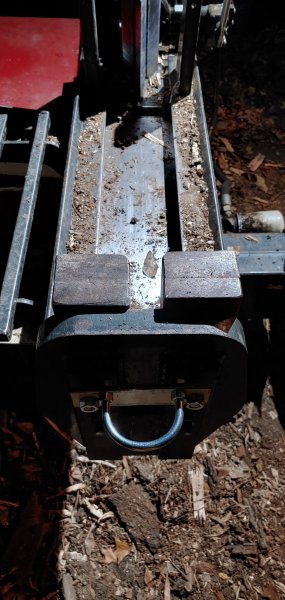

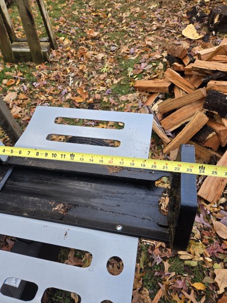

    I really like this! I’m always trying to keep a piece of 2x8 or something on the foot of the splitter, to no avail as it keeps sliding off and in short order breaks in two. When I’m splitting vertical of course!
  17. sms4life
    sms4life
    Dec 17, 2023
    495
    4,303

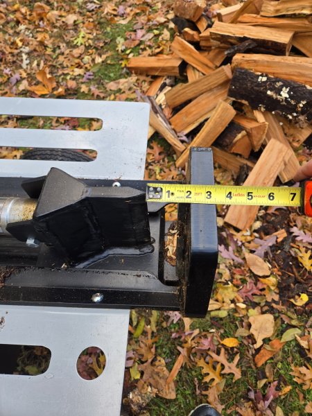

    Fully retracted
    Fully extended

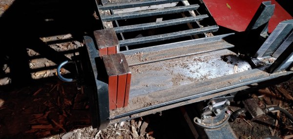

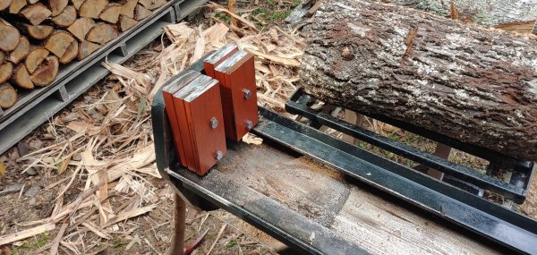

    T.Jeff Veal used this idea to make a backer for one of his splitters. His was not removable as mine was but he liked it and it worked well for him. Maybe he can post some pics of what he came up with.:handshake:
    metalcuttr, walt, JD Guy and 5 others like this.
  19. T.Jeff Veal
    29,470
    188,620
    We tried some tubing, but it bent, so we then used 1" and 1/2" flat bar stacked and bolted to the foot... 1016201941a_HDR.jpg 0813201027.jpg
