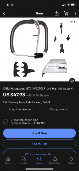

    well the outer definitely doesn't sit flat on the clutch cover, which I'm not particularly fond of. I don't have the non-captured nuts so I can't tighten it down to see how it would sit when it's tight. Amazon looks like they have the full wrap kit for 40 bucks which is less than the westcoast dogs by themselves.
    I have had the stock dogs on my 450 rancher slip on oak bark that wanted to peel off (it was dead standing) when I was really putting the coals to it.
    ETA: Huskihl, just saw your post regarding the cover not working with an outer dog... Does the wrap around kit work with the 572 or do I have to modify the clutch cover to make it work? Not sure I want to start chopping on that if I do.

    The kit includes the full wrap handle, large dogs, larger clutch cover and roller chain catcher along with hardware to secure it.
    Make sure it’s the full kit. There are sellers out there that want $50 just for the clutch cover.
    You want part # 579 50 40-01

    Your dealer may be cheaper yet. I got them from mine a year ago for $30 per kit
    You can also try this number with no spaces
    579504001

    Man! That's a deal! If everything bolts up and works, that is.

    It works perfectly. It’s an OEM kit meant for this saw

    Dealer has them for the same price. Had to order, but thats ok. They ordered the wrong chain for my bar, so I gotta go back again anyways.

    For all of that hardware, that's a smokin' deal.

    Thats a crazy low price for a oem kit, I wouldn't cobble anything at that rate. I have to ask ...are those arrows on the chain to show direction ?
