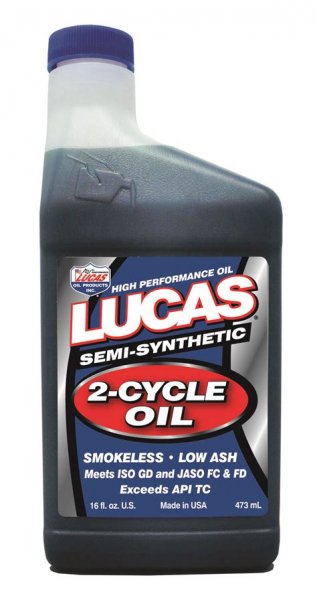

    That's fine! I'm glad to get a straight and Honest opinion! I don't have enough time, buried A$$ deep inside saws like many, and it's good hearing this things! I use my saws and only tear into them when needed. I'm no expert mechanic but can do whats needed mostly when I have time.
    No, It is the "semi-synthetic" oil.

    I thought the Lucas was semi syn? I have a quart at the house. Well it's an empty bottle that I pour RA into so that I don't have to take a gallon just around.... actually the sticker may have fallen off. Wait there is a pic of Lucas on the first page to look at...and I guess we all have Google now.
    Edit : right after that post Dave posted a pic and answer.

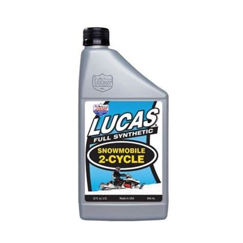

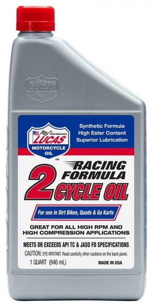

    The DO make a full syn.

    Having mineral oil in that bottle is probably the difference. And, there is no laws or rules that dictate the amount of synthetic oil vs mineral to be called semi synthetic. So for extreme examples, an oils base stock could be 1% synthetic and 99% mineral all the way up 99% synthetic 1% mineral. Both of these examples could / would be called semi synthetic.
