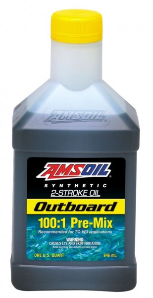

    What's funny after reading all this; A few years ago I purchased a Evinrude, 25hp E-tech outboard with oil Injection. It was running 100:1 with their XD-100 oil o_O and thats not the only thing I heard running that ratio. I think that was a bit nuts. Here's a bottle of Amsoil with a 100:1 oil mix

    Makes sense...EPA wants as little oil as possible in the air, and even more so the water...and as long as their engines make it past warranty period (plus a little hopefully) OEM doesn't care what the mixture does to the engine long term...heck, I'm sure they have no problems selling you parts!
    Many/most of those guys replace their equipment every year or 3 too...so as long as it makes it that long, they are good with it. Would it last even longer running more oil, yup. But most of us here don't put enough hours on to find out where that point is...

    Oddly enough? the oils that claimed 70-100:1 ratios did well in my lean ratio testing. Saber, Blue marble and Opti 2.
