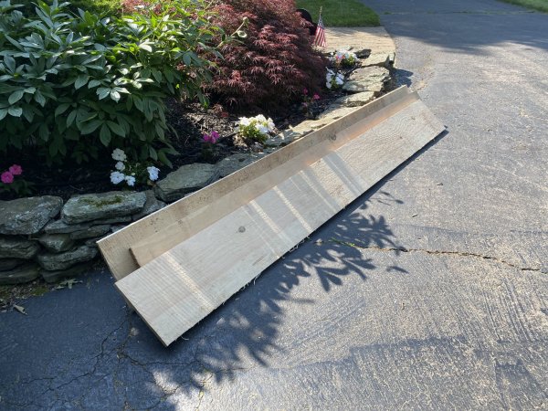

    I found some rough sawn pine boards on marketplace; 1”x12”x8’….true measurements too. $10 a board; I bought three. They still need some drying, but will sit in the garage and then the shed for another few weeks until I have some time. The seller was great, located in Southington, CT. I’ll use him again should I need any rough cut lumber.
    My plan is to prime them with an oil base primer, then paint them a grey color similar to the color of the rear ramps/gate. Right now, my thought is to attach them to the uprights using some square ubolts. I’m open to suggestions for other options.
    The boards should be the perfect height as the tops of the rails are 12” from the trailer deck. Using AI as my calculator, should be able to haul 2 yards of mulch if needed.

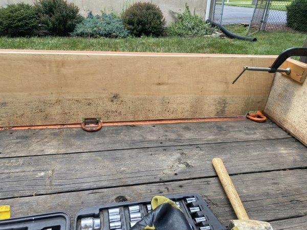

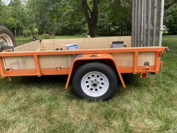

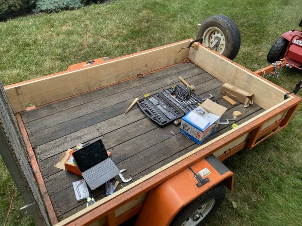

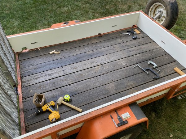

    The boards have been drying in our shed for some time now. Finally had the opportunity to cut them to size and notch out the spaces for the d rings. I used a jig saw and they came out pretty good; not finished carpentry, but good enough for a trailer.
    Hit the boards with a coat of Ben Moore acrylic primer and then mounted them to the trailer using some stainless steel u-bolts from Amazon. They fit perfectly. But the threads are kinda ‘meh’ as one had to be cut off with the angle grinder after test fitting everything. Next week, they’ll get a coat of two of deck coating from Sherwin Williams; same stuff we used on our deck and bridges in VT.

    Sides look great.
    Good coatings you put on there. Both companies use Burgess Pigment products made from GA kaolin...:thumbs:.

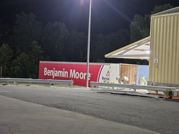

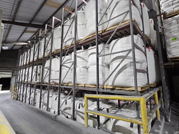

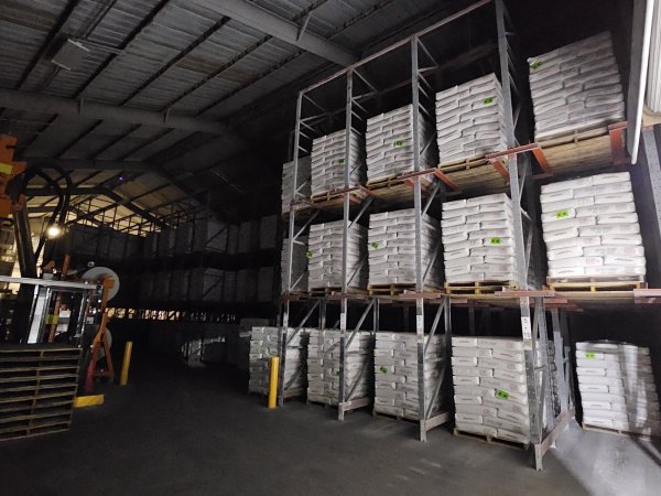

    Part of our storage system for semi-bulk bags. Bags can weigh from 750 to 2205 lbs. Those in that rack weight 1000# each/2 bags per pallet 20250728_024814.jpg

    On my end of the plant, we have 3 packaging lines/warehouses.
    The above picture with the racks of 50# bags can hold 770 tons of normal pallets of 50 bags/pallet, some loads get 60-65 bags/pallet.
    Other 2 warehouses can hold more.

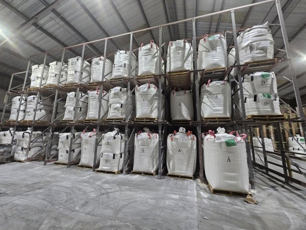

    This section can hold 450 tons...

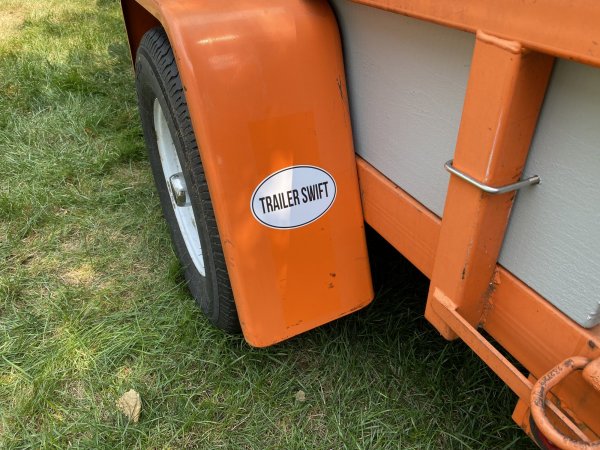

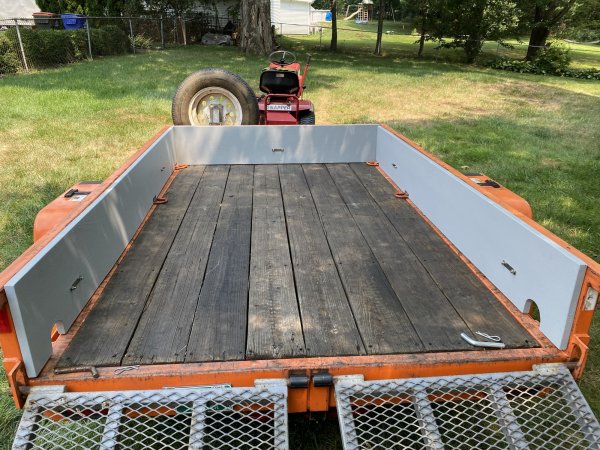

    Got the boards stained/painted and mounted up. I’m really happy with the results! It matches the gray on the tailgates, so a nice look overall.
    And since I can’t resist a good Dad Joke, I had this custom sticker made and applied it.
    :D

    Very, very nice! Trailer looks great and appears to be quite well made. So handy to have a trailer like this, will get used a lot, I bet.

    That’s one heavy duty single axle trailer. Designed to last. Fenders are a little low IMO. Careful backing it off the roadside. My license plate has been folded and unfolded numerous times LOL. I even hung it on a rubber flap and it still gets bent up. You’re going to enjoy having that around. Mine hardly ever comes off the truck anymore.

    Thanks guys! It is a really stout trailer. And good point on the fenders. Luckily, the plate is mounted to the rear of the frame. But the lowness of the fenders is a key point when doing a little off reading (which is mainly our lawn…lol).
