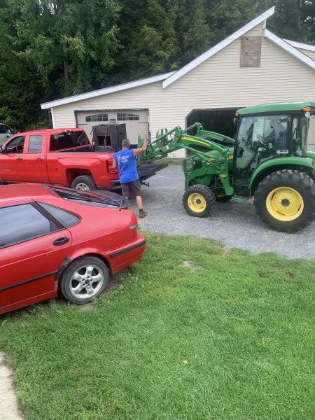

    C591D936-BF28-478F-A689-273D6C84582A.jpeg Mine if 4wd is needed a lot (read snow ice) I lift front tires off ground with bucket let them spin and it works. First tell tale sign it wants to stay in 4wd when I try to take it out. Also only use 4wd at low speeds. I respectfully disagree with SKEETER McCLUSKEY my good friend/neighbor has had 3 John Deere a 35 55 and now 75 hp with cabs all have issues since I got mine all bought new.. where my 54hp Bota has been dead reliable. He borrows Bota when his 4wd doesn’t work….
    In short some jobs 2 tractors are good
    We baby JD at top and
    Beat the Bota
