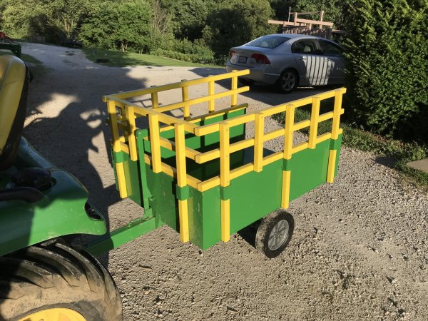

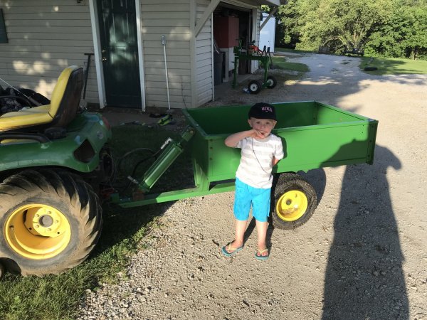

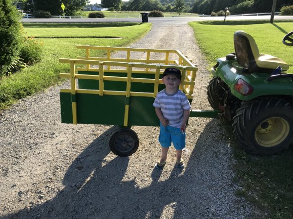

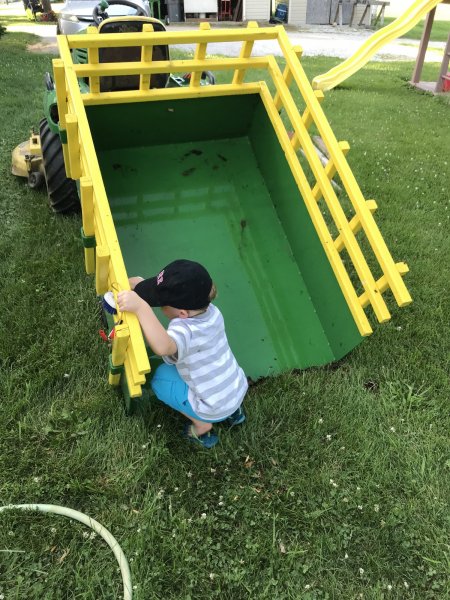

    The second is a homemade trailer that I picked up at an auction for $20. I sandblasted, painted, and modified the dump handle to eliminate accidental dumps. I added solid wheels because the wheelbarrow tires that were on it needed help. They work great as long as the ground isn’t soft. I also added the cleats on the sides and made the extensions for hauling firewood (and Grandchildren) around the yard. Once again, my grandson is not afraid of work. He is scrubbing with a brush.

    I will make a separate post for my homemade dump trailer at a later date. Thanks for the inspiration that helps me going...

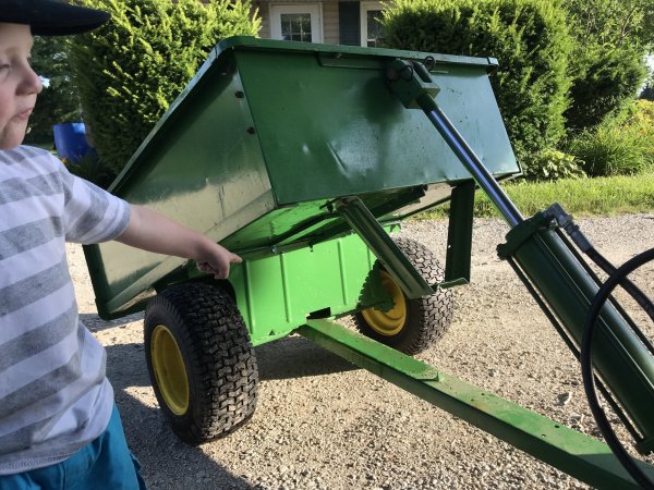

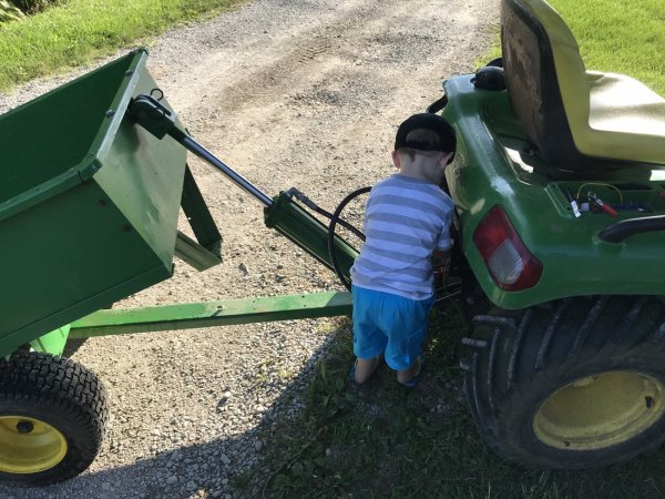

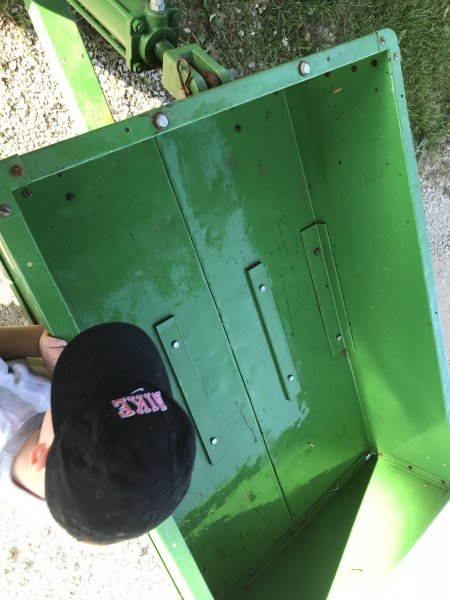

    I have been sitting back watching all the posts. I finally got the initiative to take some photos of some of my stuff for a post. For yard carts, I have two that I have modified from the condition that I originally obtained them.

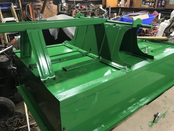

    The first is a commercial model that I believe wan an Agri-Fab or something similar. It had some rust and some sheet metal tearing where the bolts hook to the undercarriage. I fixed those problems by sandblasting and building a 3/8”x2” (what I had laying around) frame under it with 3/8” steel backer on top. I also included a ¼”x2” angle along the outside for support. As an afterthought, I added a cylinder that I had laying around doing nothing at the time. It doesn’t dump as much as I would like (for now) but it gets the jobs done.

    That cylinder looks like major over kill for that trailer. I beleive I have the same trailer, still wearing it's original chlothes.

    I Totally agree. I just had it laying there doing nothing. I got the trailer for free and it was a little rough.

    Looks nice, out of curiosity what did you use for paint?

    Rustolieum makes a good paint for stuff like that. Prep the surface good.

    Sorry for missing this but I did use unthinned Rustolium with a brush. Not looking for a showroom finish. I have found it very durable.
