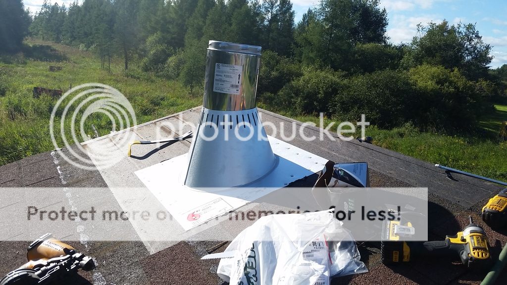

    Got most of the internal chimney work done for the Optima install.
    High of only 65F today so the attic work wasn't too miserable.
    Need to add one more section of supervent, add the rain cap/flashing then seal up the roof and we are good to go. Buddy at work is a contractor and is going to bring me half a bundle that sorta match. We will probably be redoing the roof in a couple years, no need to get picky.

    Shouldn't have nailed that down until the shingles were under the bottom.

    I nail and tar the thimble to the tar paper then shingle all round it tight to the outer diameter of the thimble. Then fill the small gap between the shingles and thimble with roofing tar.
    Never had one leak this way. I have had them leak before with shingles underneath the thimble.
    I'll take a picture tomorrow after I get it finished.
