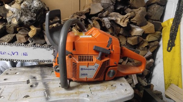

  17. Stephiedoll
    Stephiedoll
    4,038
    29,034
    Omaha, NE.
    Didn't think to take any. We do it in the morning. Kind of disappointed as 2 of the handle holes are striped on it. Was only able to go snug at best. I'll need to keep an eye on them. Got it done in time to help an arborist working across the street cut up the wood and throw it in the truck. Then went out back to noodle some bigger maple rounds. God I love this saw!
    clemsonfor likes this.
  18. clemsonfor
    clemsonfor
    15,996
    37,475
    Greenwood county SC
    Husky are bad about stripping the handles. If you can tap it bigger. Maybe put some silicone on the screw and then thread it in there

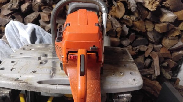

  19. Stephiedoll
    Stephiedoll
    4,038
    29,034
    Omaha, NE.
    Some pictures of the finished saw. Going to keep an eye on the bolts/screws to see how they hold up. May end up biting the bullet and ordering a new tank like I was planning on doing anyway. At least then I would have a spare.
    DexterDay likes this.
  20. clemsonfor
    clemsonfor
    15,996
    37,475
    Greenwood county SC
    Was this damage disclosed at sale? Have you mentioned it to seller. Cause you bought a working handle. They may partial or full refund you if it was an honest mistake.
