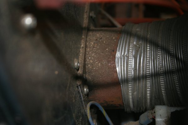

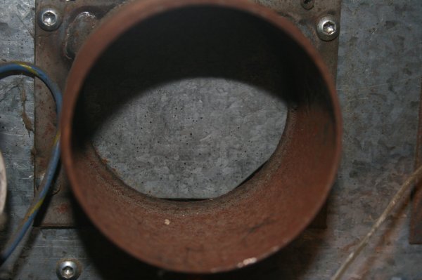

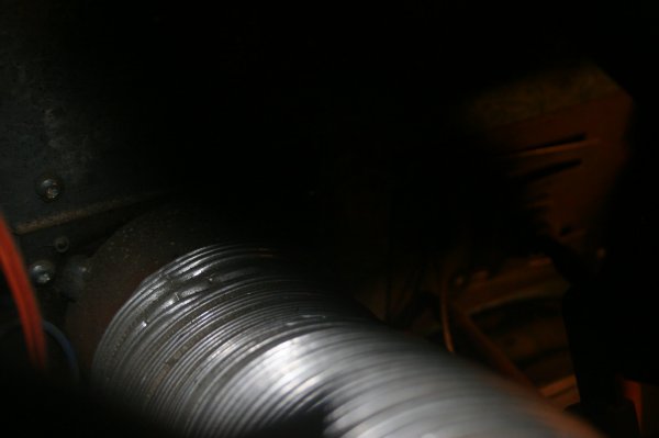

    Mine looks very similar. The flapper is also galvanized. Its hard to tell by the pic's but the stove is running and its open a bit on the bottom.

    Could be, But I think your on the right track. That flapper should be open some under load. The pic of mine is on low setting and it was close to being 1/8 inch open. High its more like 1/3 way open or so.
    I'll try and snap a pic when its going good on medium heat(level 3).
