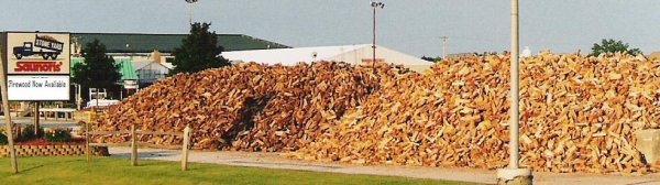

    I run 87 octane, corn liquor infused, dinosaur juice in all my stuff. The 2-strokes get synthetic oil mixed to 40:1. I have never had a fuel related issue (other than me not filling the tank) in anything, ever.
    My dad, the cheapest person I know, who heated his house for 30 years with umpteen gazillion cords of wood, only ever ran the cheapest fuel he could get (meaning 87 octane) through a Homelite 360. That saw will still try to tear your arm off if you don't give it the proper amount of respect when starting it.
    The only reason you would ever need higher than 87 in a saw is if you dramatically advanced the timing and/or increased the compression. There are certainly some saws out there that need it, but you don't buy them off the shelf. That's not an opinion....that's science and engineering. Manufactures saying to use 89 is probably their way out of a warranty claim for "improper fuel".
  19. WeldrDave
    10,195
    56,215
    :eek::eek::eek::eek::rofl: :lol::rofl: :lol::rofl: :lol::rofl: :lol: That's a lot of firewood!!!
