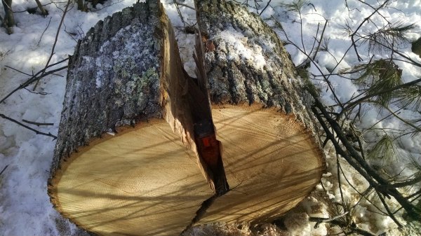

    It's cool how that big oak round came apart. Does that center core come loose without any persuasion, after splitting the outside?

    Yes. There's a layer of black stuff around the center core. Maybe, from a fire or something 50+yrs ago, that the tree survived? There's no rot in that trunk. Very odd, imo.

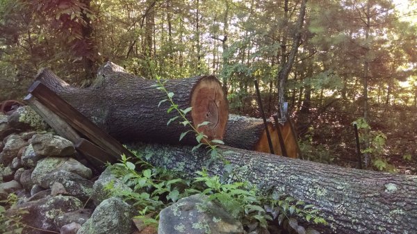

    M2theB has a new saw he bought cheap and rebuilt, and I have some big oak logs.
    M2theB wanted to see what his new saw could do, and I have some big oak logs.
    M2theB on a vacation day of his, drove to my place this morning and we played with the big logs.
    Before we started -
    The log below on the left, had been previously cut, but not all the way through. Plan was to roll it, finish the cuts, and roll them out of the way. IMG_20180629_072552884.jpg

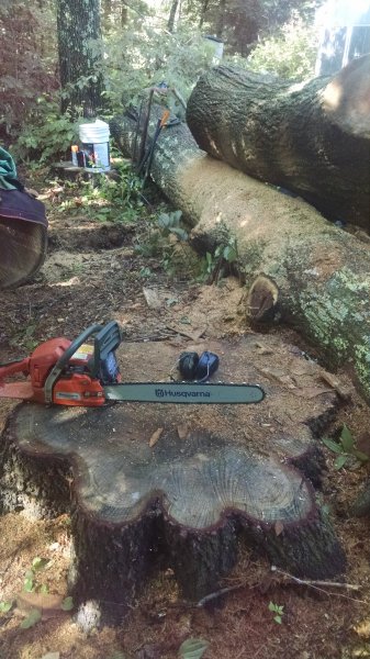

    Top log below - that's a 16" hammer.
    After the log above was out of the way, we could focus on that big one.
    Bottom log cut and rolled -or was it rolled, cut, and rolled?
    M2theB's rebuilt saw.

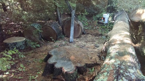

    All done - heat is rising and the dew point already was high

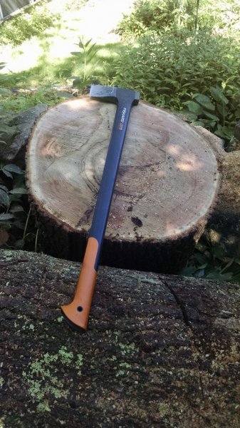

    Three rounds cut from the top log.

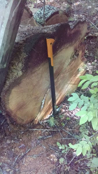

    x27 for scale
    Reverse angle
    Regarding that one long log, on the ground.. I'm hoping to be able to cut a few rounds from the middle of it, as there is daylight all the way around. Once cut, I'm hoping to be able to nibble away at it two smaller logs that are left.
