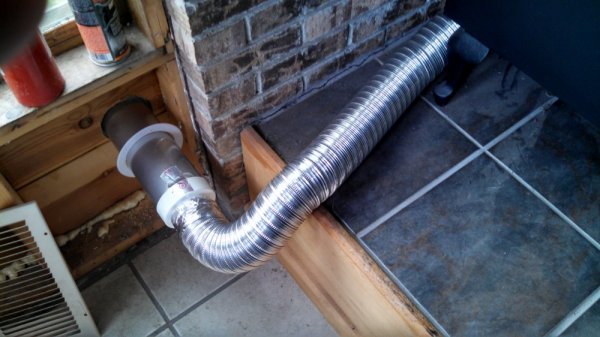

    Chris, this stove sits on an elevated hearth of about 1'. The pipe will come down out of the stove to the floor of the hearth, make a l/h turn to the edge, then down a few inches or maybe all the way to the floor, then another turn to go out the wall.

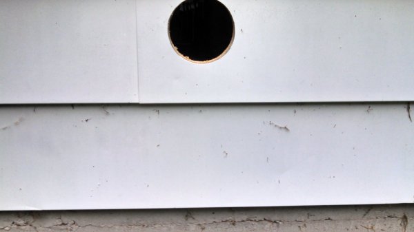

    Finally got the hole saw from my brother.
    Hey, there's a hole in my wall!

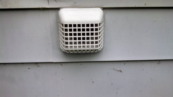

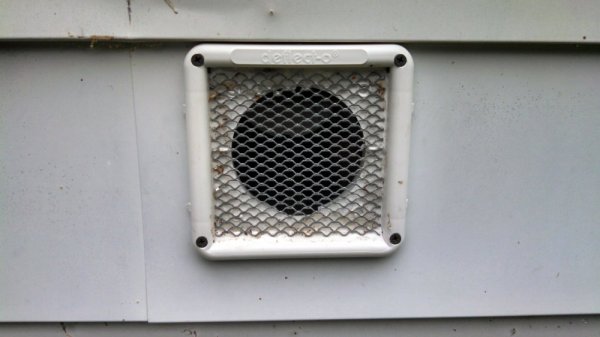

    The modified termination installed. I caulked it too, inside and out.
    Rain guard, vermin guard, hoodie thingy. :)

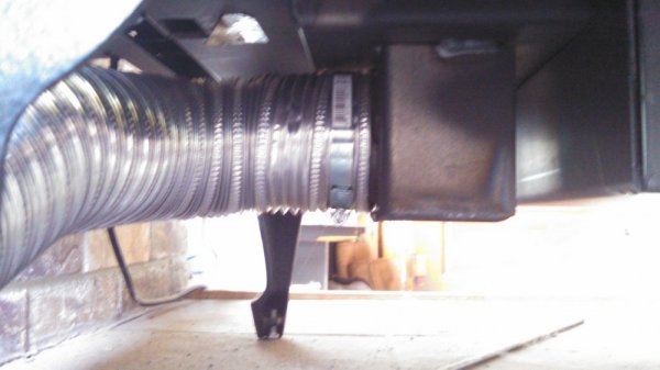

    Connection at the stove inlet.
    I need to trim this back to the wall that isn't there yet, then paint everything black....maybe.
    Supposed to get down to about 45 tonite, so it's just temped in, in case we have a fire.:D

    Where you hook up to the stove, on the nipple welded to that box, sis you look inside that box and find a huge pile of welding slag or almost steel balls in there? Mine was full of them and I don't know if they are there for some reason or just nobody cleaned them out after production. They sound real nice flying up the shopvac hose.
  11. papadave
    No, I didn't even think of that.
    Thanks for the tip though. I'll pull the tube and get a light and mirror to check it out.
    Shop vac will be at the ready.
