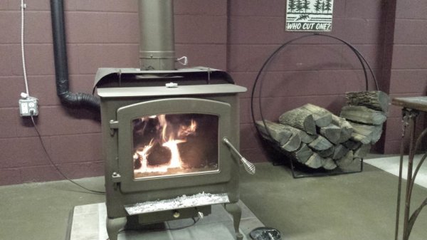

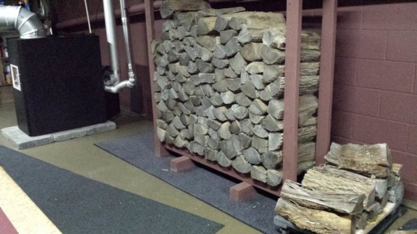

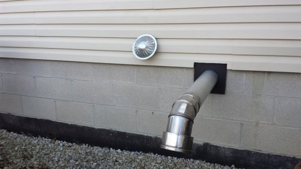

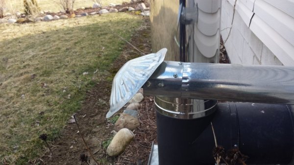

    Here are a couple pics. I just used standard 3" rigid vent and a small piece of flex vent to go from rigid to stove connection.
    Pellet furnace (inside and out)
    And then the 30-NC...

    I remember those pics, but I'm wondering why you took the term. out so far?
    I plan to attach a dryer vent hood term. right to the side of the house with the small mesh you sent me instead of the outflowing flapper.
