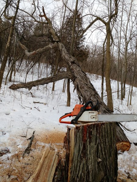

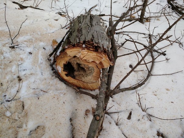

  15. Horkn
    29,195
    166,586
    IMG_20150124_111103398.jpg IMG_20150124_111057844.jpg Absolutely Mike. That one you just referenced had me VERY leery of this one I cut several days after your post.
    Heavy leaner, rotten center. The only thing for certain was which direction the top would go. I called my buddy before, and after I had it down with texts in between to let him know I was ok.

  17. Horkn
    29,195
    166,586
    It took more work to get it all the way to the ground, but I was too tired to get more pics of it when it gave up the ghost.
