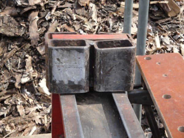

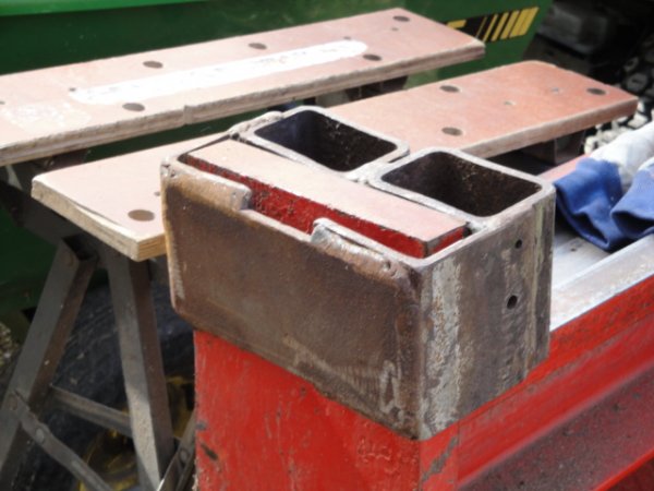

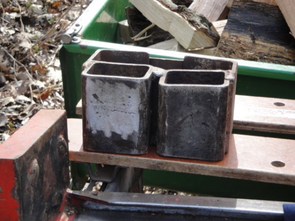

    Ok, factory was 6 bolts, 3 pet side. Here's some other pics from different didier's. Notice one has been chonda'd with a blue chonda.
    Looks like many didier's had to have the ram rebuilt. This one was on a farm until we bought it, and they did a decent enough farm engineering fix.
    I think the one I have above in the close up picture was factory. Others I've seen are like ours, or with fresh welds.

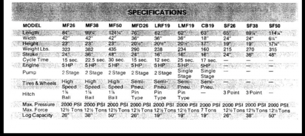

    Edit. Found this. See attachment. Apparently all Didier are 12.5 ton rated. Ours is a mf26 based on description. Screenshot_20200511-125233~2.png

  8. brenndatomu
    25,079
    162,864
    MF50...30 second cycle times...wow.
    Horkn and Chazsbetterhalf like this.
  9. Horkn
    29,159
    166,364
    Yep, that's because the beam and cylinder are longer. That's but a 50" long log. The mf26 can do 26" long, and the 28 does up to 38" long.
    Same hp, same tonnage.
