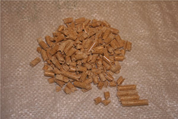

    Disclaimer: This is only a home test....YOUR MILEAGE MAY VARY....this review is just my 2 cents.
    Temp average 259ºF
    Bulk Density 42.21 LBS.
    (Calculated with PFI standard #8.1.1 using ASTM E 873 procedure)

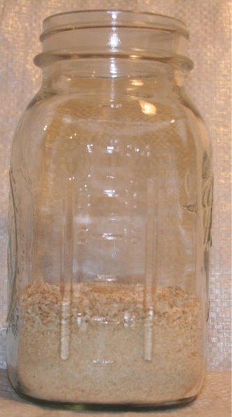

    Fines volume 8 ounces
    (Visual=for show only)
    Fines Percentage 0.23%
    (Calculated with PFI standard #8.1.4 procedure).

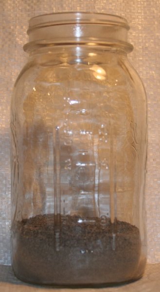

    Ash volume 6 ounces
    Ash Percentage 0.33%
    (Calculated with PFI standard #8.1.6 using ASTM D 1102 procedure)
    Ash Percentage Stove 0.30%
    (just for comparison, disregard!)

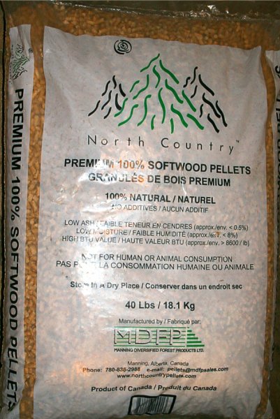

    Bag Weight 40.06 Lbs. net
    Diameter .254
    Length 1/4 to 1 inches
    Total Burn Time 12 hrs. 46 min.
    (Temp set to 250ºF on stove-Feed 3 trim 2)
    Estimated Pounds per hour 3.22Lbs.
    Pro's: Good heat and low ash
    Con's: None that I saw
    Notes: A SPF pellet that burn's very nicely. Wish I could give these 4 1/2 stars!!
