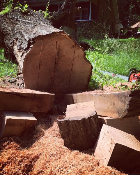

    That was the coolest thing to see you noodle that behemoth oak last Summer. Did you noodle first then buck???

    Yep. If I can, I noodle first so the wood is being held firm. Those rounds were massive and would have been wayyyy too heavy to move full size.
    Some rounds are just too big and heavy so the quickest method (that's easiest on my body) is to noodle 'em up.

    Saw had a 37" bar and chain on it. When noodling, the best method is to not bury the tip of the bar.

    Is that you? If so, nice to put a face (well, profile) to the user name!
  11. The Wood Wolverine
    18,497
    118,677
    Yep that's me. Wood score was this: Scored some poplar
