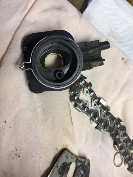

    If the muffler is already loose, pull it off and let's have a look at the piston. Difficulties with the low side raise a flag right away on possible air leak.

    Nice find! From what you describe I would suspect a leaking fuel line (in the tank) or maybe even leaky crank seal(s), hope not, hopefully it is just carb related...:yes:

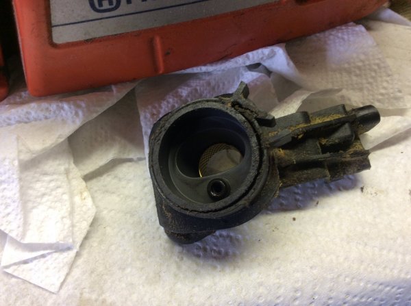

    Address the intake boot as first mentioned by MasterMech and pull the muffler check the piston for scoring.
    Before my 351 died due to the leaky clamp (Stihl intake clamp used during my rebuild) it had similar symptoms.
    Nonetheless, nice saw if you get it running proper. Good aftermarket top ends now available to turn it into a 346xp for decent price.

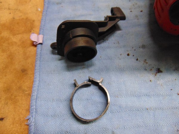

    Near minute 10:30 and on he gives a nice explanation of the issue with the clamp.
    Piston looks dirty, but not scored and the exhaust port is clean. Fuel line is in good shape. I'm going to head down the road to change to the metal clamp.

    I think you nailed it. Although not cracked, even when the latch is engaged there's no compression on the seal. That might explain why it will run better when I baby it and gets hot, allowing the cylinder inlet port to expand so eventually a seal is created.

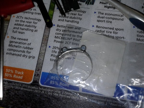

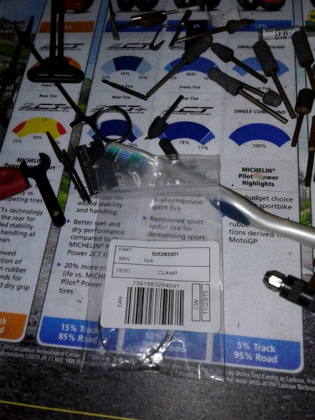

    All I do is cut off the plastic clamp and put on a 372 screw type metal one. Pretty cheap fix. I'll find the part number for ya.

    So for the cost of this clamp, you'd be good to go.

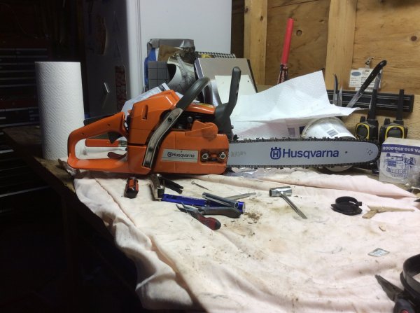

    IMG_0443.JPG IMG_0439.JPG IMG_4087.JPG I bought the $7 clip/boot transition. I pulled the jug to deal with it and I'm glad I did. Put it all back together and it runs like a champ. Went out and got a 16" bar for it.
    It was a good find. If for no other reason than I've never torn a saw apart. Excellent learning experience and I've got another saw to boot.
