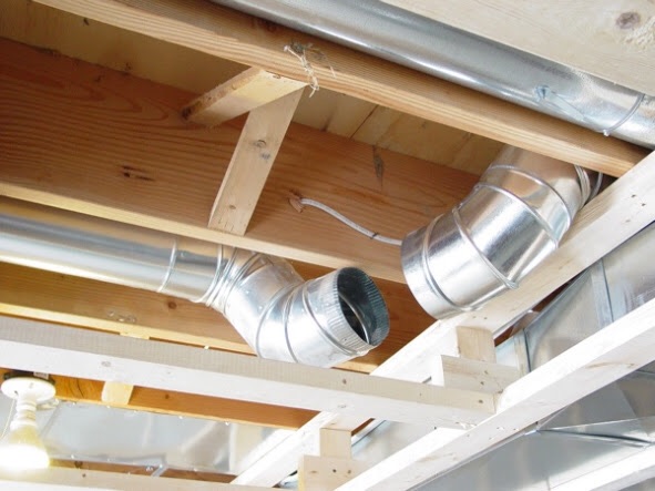

    Does the cold air return matter if I install 90 degree bends? I know normally 45's are easier on air but I am not sure if it matters on cold air returns. Someone chime in, I have 10" round ducts going up soon. They will run up and inside the floor joist.
    When I hit the end of the run, I will need to come out of the floor joist cavity and over across the joist , and down to land inside the furnace cold air return box.

    Will need to do similar to hot air supply also. It's the next bay over.

  7. 343amc
    343amc
    1,749
    5,770
    Northeast Lower Michigan
    I wondered the same when I first saw mine but came up with an easy answer.
    Gravity. :)
    It's not going anywhere if mounted only at the top. If you need to take it off to get at the room air blower you don't want to be trying to get underneath it to get at hidden fasteners. No harm if a small amount of basement air gets sucked in.
    A normal propane or oil furnace has a removable panel to get to the room blower. No such animal on the Fahrenheit, so removing the cold air return box doubles as your access to the blower for removal or servicing.

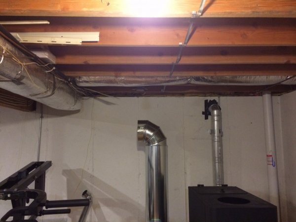

  15. Triple A Arsenal
    Triple A Arsenal
    Sep 25, 2014
    710
    1,320
    New Haven, CT
    Ok I need advise, so I am looking to see how I am gonna route the cold return and hot supply.
    I realized that the main trunk looks like 14 x 8 rectangle but then reduces to 10.5 x 8 rectangle.
    How do you think I should tap into the 10.5 x 8 rectangle trunk?
    Now the cold air return trunk doesn't reach the back wall. So I have to extend it myself, the plan was to use round 10" but since it's a 14 x 8 rectangle trunk I can't find something to transition me into the round.
    I still have the ability to purchase the 14 x 8 duct and run it 15' or so back. Then use a 10" takeoff from under if I have to go this route.
    In the pic you can see the hot supply on the left. Not in the pic is also the cold to the left of it but it doesn't go as far down.

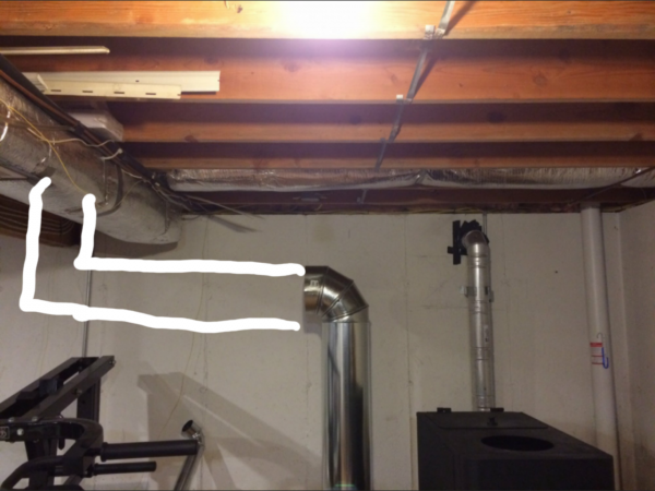

  16. DexterDay
    DexterDay Administrator
    12,411
    31,637
    Northeast Oh
    I would go over, and then turn up.
    As long as both are big enough to accept the 10" round duct? Just use a 10" starter piece?
    Make a 10" round hole, then use a starter.

  17. Triple A Arsenal
    Triple A Arsenal
    Sep 25, 2014
    710
    1,320
    New Haven, CT
    That's the problem, I can't get the 10" collar on a 10" rectangle underside. Or the 8" side wall.

  20. mithesaint
    mithesaint
    Jan 9, 2014
    534
    1,168
    NW Ohio
    I don't know enough about air flow dynamics, but I do know that the 4.5x18.5 hole is larger than the 10" hole, so it shouldn't slow things down too much...I think. They also make a 8x12 to 10" round transition piece, but I haven't had any luck locating that piece for sale anywhere. Broan makes it, but no one actually sells it as far as I can tell.
