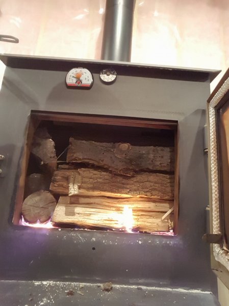

  8. Chaz
    Chaz
    Jan 27, 2018
    8,755
    62,099
    Southwestern NY
    It's funny you mention the E/W N/S loading. When I first started reading here to research stoves, I was absolutely lost on what that meant or why it would even matter, it's a woodstove, not a compass. :)
    Couldn't fathom why no-one said Front-Back and Side-Side.
    I still don't understand any reason it would burn better or worse depending on load direction. Is there some airflow difference that would make it burn better or worse?
    I loaded her up pretty full last night, and dampered it way down (~1/4). Had some great secondary burn action, and when going to the B'room @ 4AM took a look at temps, still 73 with lots of wood left in stove.
    Wife (who is retired) wakes up between 5:30 and 6:00 AM and she said she threw more wood in, 5 or 6 splits, but I don't think any wood was actually necessary at that point. She also said it was 71 in the living room.
    As stated, we will have to experiment to find out what works best, I don't really need the house in the 70's when we're in bed, but I do want good coalbed for some heat and re-starts in AM. I'm contemplating packing it in the evenings around 7 PM, dampering it down, and see how that works in the AM. If on low it might be just what I'm after, without burning wood excessively overnight.
    Last year was quite a bust in bringing in wood due to several reasons, but I packed in only 7 of the 10 face cord I like to have ready for winter. Worst winter we had we went through 8+ face cord. I figure we've got 3 of the 7 face cord of wood we started the winter with, we went through a LOT of wood during the cold snap with the old stove. We may be relying on the Fuel Oil furnace before the end of winter, but we'll see how things go. Not much I can do about it now anyways.

  9. Suburban wood snob
    Suburban wood snob
    Oct 13, 2017
    927
    3,964
    Milwaukee
    NS might breath better as you don't have those no oxygen areas behind the big EW logs...and fewer clinkers.
    The real advantage is simply how large of a load you can run.

  10. BDF
    BDF
    Jul 22, 2014
    2,160
    7,533
    Virginia
    Yeah, lots of debate on how to load a wood stove. :) My own personal opinion, specifically for an Ideal Steel is.... I do not know.
    Some things are pretty obvious; loading N/S with a front draft supplied stove (most modern woodstoves with glass in the doors introduce the primary air in the front), the fresh splits will start faster than if loaded E/W because some air can flow between the splits from front to back.
    With a side loading stove, it is virtually always easiest and best to load them E/W; the stove will fill better, can use much longer splits, and is pretty easy to fill very full of splits.
    Front loading stoves are less obvious as to the best way to load them. The Ideal Steel throws another wrench in the works because the top of the stove is tapered toward the back, so while there will be room for an entire row of splits in the front, you cannot get them in there because there is no room at the back. But because the stove is considerably wider than it is deep, if the firewood is cut to load N/S (about 17" or 18" max.), then it will not fill the stove when loading that same wood E/W. Of course if the wood is cut for E/W loading, then the stove must be loaded that way 'cause the splits will break the glass in the door every-time it is closed :)
    What I started to do is to cut my splits to 20" for E/W loading but then ended up with a mix of wood I cut and wood purchased, the bought stuff cut short, to about 16" so that whole plan went down the drain. Still, I think that is the best way to load an Ideal Steel: E/W, with longer splits and pack the stove to the gills. There will be a little airspace of the side of the firebox but hey, it it tough to fill any stove like a Tetras game anyway. Besides, even if one loading is just outstanding regarding the amount of wood you got in the stove, the next one will be different anyway.

  11. Canadian border VT
    19,829
    132,287
    BDF, my stoves gets 2 layers n/s and a couple of longer ones EW on top., its full, way I have found to get most wood in. More wood equals more heat.

  12. Chaz
    Chaz
    Jan 27, 2018
    8,755
    62,099
    Southwestern NY
    Funny that you mention that, as I was sitting here reading, it occurred to me that if it starts faster/better with N/S splits, then one layer of N/S with E/W on top of that.
    As to log length, I unfortunately am not very disciplined when it comes to cut length. My main objective is to keep around 18" as that is bar length and somewhat easy to gauge. That being said, it is not surprising for me to have a mix of 20-21" in the mix as I can't bring myself to sacrifice the extra inches when I come to the end of a log. If need be I'll cut 2 shorty's rather than have the waste.
    Quite often the shorty's are set to the side and stacked for outdoor recreational burning.:fire::coldone::popcorn:

  13. BDF
    BDF
    Jul 22, 2014
    2,160
    7,533
    Virginia
    Yep, the goal is always to stuff more in there (Boys!). And I do load the shorter stuff N/S because it absolutely does fill the stove better. But as an inherently lazy guy looking for the fast and easy solution, I am going to again try for 20" splits, loaded E/W and hope see how that works for me for a season or two.
    My stove needs should DRASTICALLY change as this house re-build progresses too, so jamming the last stick of wood in the stove will not be such an issue.
    Brian
    Chaz likes this.
  14. BDF
    BDF
    Jul 22, 2014
    2,160
    7,533
    Virginia
    If you can not hold the wood length pretty consistent, you will be much better served with 16" to 17" wood, which can be loaded either way. And if that varies to 19", it can still be loaded E/W.
    When I cut to 20", not only can the splits not be 20 1/2", but the larger splits sometimes will not even go at 20" because the far edge of the split hits before the near edge will clear the door opening. If I am not very careful, I end up with a fair number of splits that end up needing a little trimming on the porch to get into the stove, and that is a pretty big pain to keep a saw out there, cut the end off a split that is sitting on a pile of wood in a trailer, etc. Put another way, it is 'not slick'.
    In the end, I may end up back to 17" to nearly 18", pull the andirons out and basically load N/S. It probably is the best way to most consistently load the stove over the long haul.
