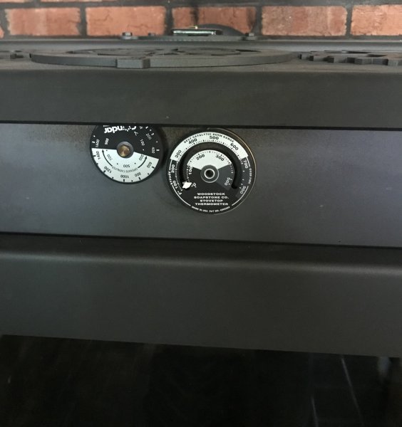

    Oh another interesting thing Qyota is that the hottest outside surface of the IS will be front face above the door immediately to the right of the Allen screw. Perhaps stick your magnetic thermo there to see a better idea of how much intense heat your cat makes.
    The cat probe (upside down scale) is on the left and the stick on thermo is on the stoves hot spot (not WiFi LOL).
    Qyota and papadave like this.

    Would that be the temperature on the surface of the stove as I dont think that is "fairly cool" at all.
  17. Canadian border VT
    19,841
    132,386
    BDF runs probes.. with a Thermacouples inside stove, cat temp stove top and flue I believe
  18. BDF
    BDF
    Jul 22, 2014
    2,160
    7,533
    Virginia
    No, those temps. are actual measurements taken inside the firebox and they are pretty low.
    And I absolutely agree, and I.S. running 500F and higher on the outside surface of the stove is certainly NOT running slowly, that would be what I consider running pretty hard. I rarely seen 500F on my stovetop.
    Brian
  19. TurboDiesel
    16,245
    97,592
    I usually see 600-800 on the front of the stove above the door to the right of the allen screw. I tend to run mine hard since its a basement install and i need to get enough heat to the main level.
  20. Canadian border VT
    19,841
    132,386
    TurboDiesel those are outside readings.. I get those too... but BDF readings are inside or true temps he got thermacouples inside firebox ... Tom at Woodstock said not to worry I'm barely stretching it's legs at those temps..
