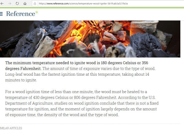

    Where did you get that number? I have always heard less than that...and whatever it is, it drops as time goes by due to drying, and when next to a stove (or any other heat source) pyrolysis...and there are documented cases where fires were starting in old building framing caused by hot water pipes...that were under 200*F! (190* if memory serves)
    Here is an article about this subject...there are tons more out there too.

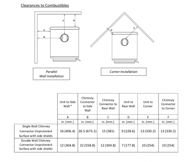

    Does the manual show the clearance with a shield for the sides? Or is the shield standard on the stove? If it's not listed with a different clearance with a shield then I think the side clearance for that stove is showing 16" from the sides. If the manual says 16" as is, and the shield is standard equipment I think the clearances still are 16". Could be wrong, just guessing.
  8. Kimberly
    Kimberly
    Mar 19, 2015
    5,072
    12,819
    The Kangaroo State
    Yes. However, the shields don't cover the full sides of the stove; therefore, the minimal clearances has to be from the unshielded parts of the sides. The shields wrap part way around the sides to improve the back clearance of the stove. If one uses a double walled stove pipe the clearance on the rear of the stove drops to seven inches.
    However, I do agree that putting an additional heat shield is a smart move; the old adage, "Better safe than sorry."

    It is a listed stove so the manual sets specs. If there is any question it needs to be asked of the manufacturer. But in general no a second sheild won't reduce clearances below 12"
  11. yooperdave
    35,929
    226,118
    Are you sure about this?
    I have never heard of a stove's CTC reducing if "one" uses different apps of vent pipe.
    Normally, the CTC that reduces by using a double wall vent pipe is only the vent pipe's CTC.....
    May want to read once again.
    Screwloose and Chazsbetterhalf like this.

    Englander has some weird deal with double wall pipe on some models (nc13 is one maybe?) where CTC actually goes UP when using DW... IIRC, it is because the draft improves enough to make the stove burn hotter...

    Scroll back through the posts Warner posted a clearance chart for the stove. I may have read it wrong.

    It is extremely common to have listed CTC reduced in the manual with doublewall pipe. Because with modern shielded stoves safe clearances for the stove put the pipe much closer than 18". But you can't do that with single wall so they list a seperate set for single and double

    So with double wall pipe, and the installed side shields clearance to combustible is 12". There's your distance needed for the racks of wood to be within the manuals specs.

    That very well could be but what the insurance company /fire dept. /installation inspection municipality team(s) are going to refer to is documentation.
    For the Madison/01 (what I call it)/ 2000BTU version of the Smart Stove there is no difference for double wall pipe (in the documentation) - it's single wall clearances only.
    Once you exit the stove the CTC from the documentation of the stove pipe takes precedence.
    CTC and pyrolysis aging becomes less of an issue if the stock in the racks is rolling stock, it's just not going to sit there long enough to be an issue beyond CTC concerns.
    Besides, CTC isn't the only issue with fuel supplies close to a stove. Personally I'd be even more concerned with ember protection and encroaching on that ember protection space. IMO, minimum protection cuts safety razor thin, again, my opinion.
