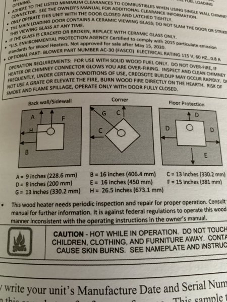

    I need to dig my manual out and see the clearances again, they are fairly low at the shields. I pulled the manual up online, the clearance from the back of the stove to wall is 9 inches. That should be the same for the sides where the shields are located. So, I should be good if I place the racks nine inches from the side shields.

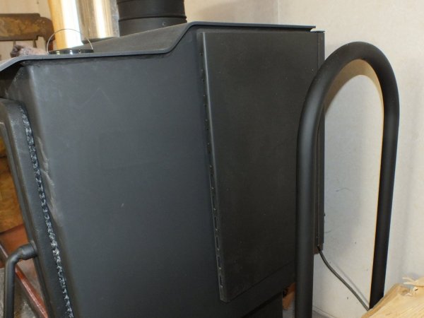

    I actually thought about that as well. However, the side shields don't go the full width of the sides. Plus, I don't have the space in front of the racks for the shovel and poker etc. I may do as you say though and see how it works out; but the wood may get hotter where the side shields stop.

    Where are the shields? I can't see them on the picture you posted. I think moving the racks 90 degrees and to the edges of the hearth you'd be safe. Keep us poste .

    OK, I understand. That is the best place for me to stack wood. So if I place an additional shield I should be OK since the stove has a partial side shield as shown below.

    Some on here appear to think I do. I thought that the side heat shields would be enough to give me safe distance. The stove's manual states 9 inches from the back heat shield to the wall so I figured the same would apply on the sides where the heat shields are located.

    What does the manual say for side clearances?

    Yes, but there is a shield that covers part of the side; I certainly would keep distance from the unshielded part of the side. However, I can get something; cement board or some sheet metal, and create an additional shield for the rack. The old adage "Better safe than sorry."
