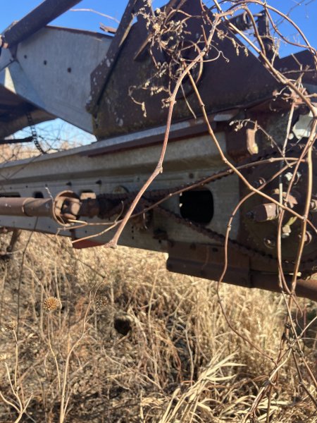

  17. JimBear
    JimBear
    Aug 9, 2020
    3,434
    20,956
    Apparently my brother robbed the motor for an unloading auger on a grain bin.
    If I remember correctly it had a 4- 5hp electric motor.
    Here is the pics from both sides, we just removed the pto shaft if using electricity.
    Near as I could tell with out a tape measure that is a 12”!pulley.
    eatonpcat, walt, Stephiedoll and 3 others like this.
