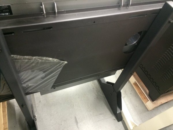

    I bump into the stove today so I took some pics, Very impressive. Just secure the mounting plate to the studs and cut the hole for the standard exhaust PL pipe!
    Manual shows safe and easy install!
    What do you pellet people think about it?
    Link to owner's maual
    http://www.usstove.com/image/manuals/Pellet/4840.pdf
    See pics
    Click to Enlarge:

    I'll wait to pass judgement until after the heating season and any structure fire reports come out.
    If these follow in the footsteps of the window mount stove, then it may be a good idea with not so good execution.
    Did you happen to see if USS is making these themselves, or are they made in China like the window units?
    All that said, it would be handy for a shop, but I wouldn't trust it in my house.

    It most definately is an improvement. If the exhuast vent on the window unit was not installed or came off it was a real danger. That cannot happen with this stove. There are other improvements in the firebox too! It just maybe a real good unit now! I would like to try one. Maybe I will build another shed for it. :)

    I know people are Leary, but according to my technical resources the part in the fire box that was trouble is not only made better but is replaceable. Also the exhaust system which was the cause of the fires uses pl type venting now! Very encouraging!
