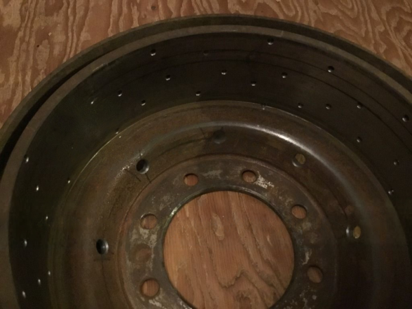

    Speaking of brakes. I drilled the drums on my truck years ago. Drums build up brake dust and it acts kind of like ball bearings between the shoe and drum, reducing braking power. The drilled drums have been working great for many years. Consistent, full power brakes every time with no “dust fade”, and they stay cooler too.
    I had to use ai to remove the watermark, so a few holes are “missing”, but you can get the idea. I drilled 1/2” holes just outside the hub mounting area for fresh air inlets and .2” holes in a double pattern through the braking surface. The double pattern maintains balance. A total of 64 holes were drilled in each drum. The entire shoe area is swept by the holes, so nothing can get trapped in the drum. All dust is evacuated 4x with every turn of the wheel.
