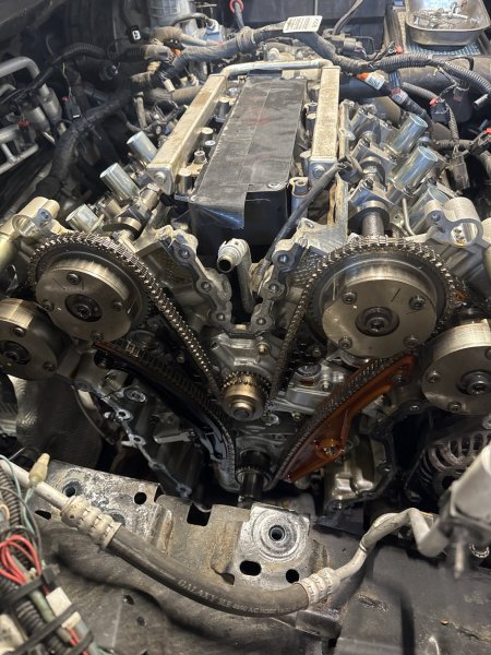

    image.jpg Did somebody mention water pump fun?

    Guess the engine game. :DI was going to say Cummins, but they are usually red.

    Oh yeah....I'll play...I was actually studying the pic earlier trying to figure it out...Ima guess a Ford 3.5 V6, just because I know they have this setup. :headbang:
    I have no idea why they got away from the external water pump being driven off the back of the front cam, via a small belt...that was a vastly superior setup, especially on a front wheel drive vehicle, IMO.

    Well you do have some prior info on it…:rofl: :lol:
    You are correct

    Don't know why I was thinking that was a straight 6. The tape threw me for a loop.

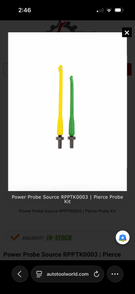

    Then you have this gem IMG_5760.png I saw my coworker using it:hair: asked him what it was knowing already. He said it pokes the wire but then the insulation self seals. NFW! Then asked him if he thought that we didn’t already have enough problems to deal with…!
  12. eatonpcat
    10,369
    59,247
    Must be Magic!
