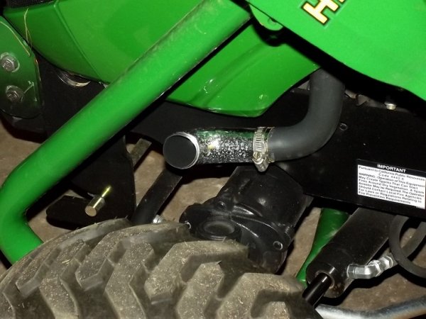

    Also, invest in a $3.00 piece of 1¼" chrome plated brass kitchen sink drain pipe and use it as an elbow on the end of the factory exhaust. It will divert the exhaust out to the side, away from the back of the loader or front mounted implement. Hot exhaust gas blowing on the back of a snowblower makes for a clogging, icy mess...

    Also, some people have used a short 90º pre-formed silicone heater hose elbow from a car... like this... to the exhaust. Adding anything to divert the exhaust will keep everything so much cleaner!!
    Just as long as it's short and light.....
