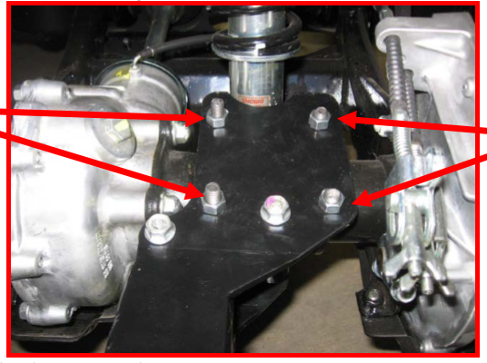

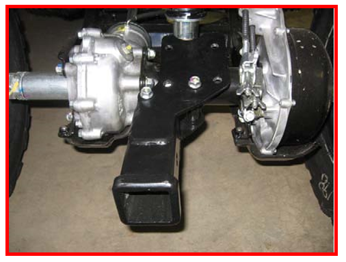

    I looked up the install manual for this hitch...it doesn't mount to the frame...it mounts to the stock hitch holes (which is part of the axle housing) plus has 2 U-bolts that goes around the axle housing...so its connected pretty well...and built pretty heavy...but man, I really don't like how far back it hangs. That is in effect putting more load on the axle housing because of increased leverage...I dunno, maybe I'm overthinking this and there won't be the kind of stress on it that I think. I do tend to overbuild things (but they never break either) The size logs in your pics should not be too hard to move with the log arch and Rancher.
    But I gotta say, I'd be real tempted to drop a ball in that factory hitch and go loggin...never seen or heard of a Honda hitch breaking to be honest.
    I Agree with going with the ball coupler VS hitch pin...a lot less slapping around from the free play in the hitch pin and the holes.
    My two cents on the matter...with inflation, might be worth 3 cents.:whistle:

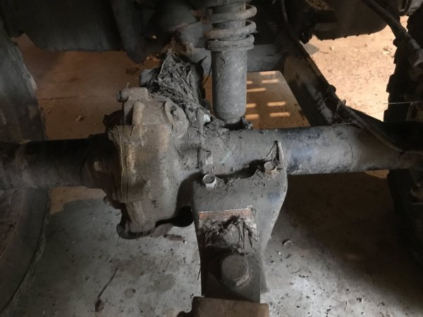

    I think it makes a right turn around that shock and I'm thinking the second u-bolt must go around that frame member. We'll see. If it's levered too far out though I totally agree. I also like to overthink and over-engineer things too, as you might have noticed. :handshake:

    Snipped pics from the install directions. See how far it hangs out...
    upload_2017-6-15_21-42-51.png upload_2017-6-15_21-43-51.png U bolts around the axle...
    The bike in the pics is slightly different than yours, but the fitment will be the same...pretty typical Honda setup for quite a few years.

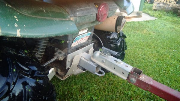

    This is my hitch.
    Another reason to go with a ball hitch is if the log you are pulling gets stuck between a couple of trees while you are turning a corner the log arch will come unhooked on its own when it flips over. I might have been going a bit to fast ,this has happened many times. I keep the tension adjusted real light on the ball hitch so when the arch flips it comes off easy

    That looks like a pretty strong setup...they mount the hitch on those IRS bikes completely differently than the straight axle ones. What brand receiver is that? I like how it is tucked up pretty tight to the bike.
  15. walt
    walt
    Jan 24, 2016
    988
    8,769
    north central ohio
    The hitch is homemade a friend made it for me. For me factory hitchs are to low and to far back under the rear rack

    Don't do that. Seriously, on the axle is where you want it. You just want to remove that apparatus and bolt the ball directly to the axle.
    Solid rear axles are the preferred HD mount for towing big loads. IRS machines have to pull by the frame, and it weights the suspension down. Because of that IRS machines can't tow as much.
    But, I don't see an issue with towing 8-16" logs with a log arch on any ATV. Not one at a time anyway.
