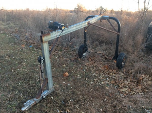

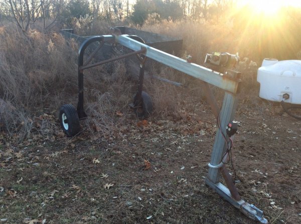

    cre73, do you have pictures of your homemade log arch. That is a project on my list although we may be able to get by with a cradle axle / dolly set up at the rear of the log and use the carry all on the 3 pt hitch of the tractor to pull em out of the woods and across the creek. I'm still pondering ideas on that one... any suggestions or pictures would be appreciated.

    If I don't have any I will get some. I haven't used it in a few years. Once I fabbed up a jib pole for the tractor I quit using it.

    5616311D-60C8-4B8B-98BB-07306C679AE4.jpeg A478B196-3E2B-4637-B776-A0176602B471.jpeg
    Here are the pics.

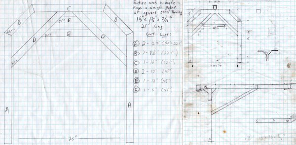

    Here is Some info you might be able to get some ideas from a link a PDF file at the bottom, and a Picture I had in my files.
    I thought I had some other stuff but I can't seem to find it
    https://www.motherearthnews.com/diy/log-hauler-zmaz85sozgoe
