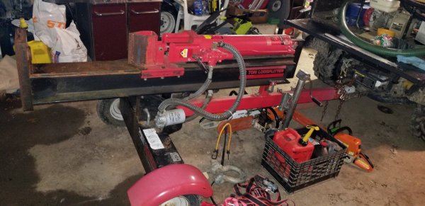

    Good morning all. I just got my hands on what I believe to be around a 20 year old splitter, in remarkable condition for the age. Long story short, a good friend and neighbors house exploded, and he has declared he isn't planning to heat with wood in the rebuild. He told me to take the splitter.
    So anyway, it probably has not been run in 2 years. He preferred to split by hand, so it sat a lot between uses. Around 2 years ago he put a cheap chinese carb on it, and said it was never right after that. I only made sure it spins, did not waste gas trying to start. I have ordered an OEM carb. Also replacing fuel lines, shut off valve, oil, spark plug, air filter cartridge, and air filter foam. Also the hydro filter, as it appears to have the original still in place. I have used this splitter before I had my own, and I recall the auto return detent not always holding, I have researched a few tricks for that.

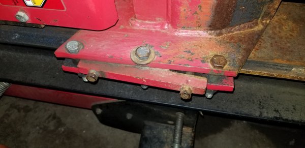

    Anyway, my question here, is does anyone have experience with this weird shim system it has? It seems more complicated then things need to be, the blocks fall out, and I am thinking of just replacing it with a nice stout bracket. Any reason I shouldn't? The contraption in question is the third pic. 20190212_193746_resized.jpg 20190212_193810_resized.jpg 20190212_193827_resized.jpg

    My neighbor has a splitter like that...he has issues with it breaking the bolts on the wedge slide bracket thingamabob there...

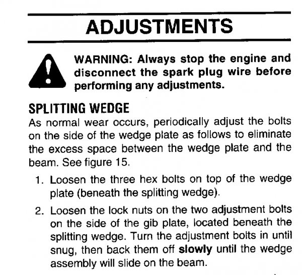

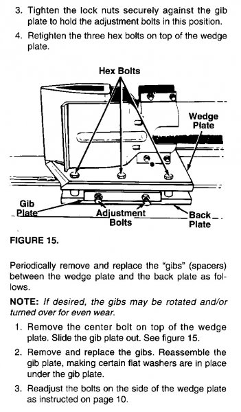

    We have one like that. An MTD 20 ton with 5 hp B&S engine and love it.
    The shims are said to need replacing but I have never done so. I remember getting a lit of wobble in the wedge so did make something for a shim but don't remember what I did. It was a cheap fix. Splitter is well over 20 years old. I think around 30 years now. We did replace the engine but that is another story. Should not have had to do that but sometimes when you lend out machines they don't always come back as they should...
    If you like I can dig out the manual and print out for you what they say to do with the shims. Just let me know.

    The info about the shims would be helpful. I looked around a little online, and it looks like they are just 5/8 bar stock. I haven't asked my buddy if he might have the book. Only chance is if it is in the garage, which is also totaled, but still standing. He has enough to worry about right now. If it's easier, you could just take a picture of those pages and post them? Maybe I will make up a set and put them in, and do something different if it is a problem down the road.

    Okay. Will look up the book in a little bit. If not today then tomorrow for sure.

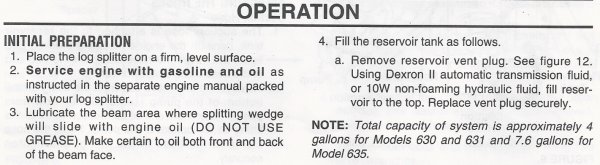

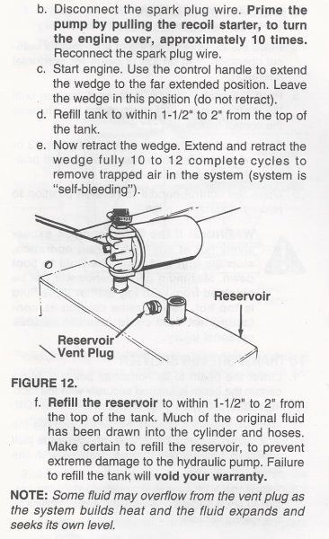

    I don't know if this number is still in operation but is in the manual: 800-800-7310 for Parts and Service
    Thought you might also like the following for filling with fluid.
    If any other information is needed, just ask.

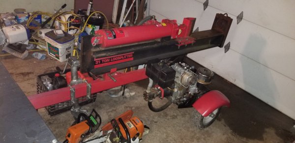

    So after installing the missing spring, it made no discernable difference. Took it to an old friend of my father's that has a small local shop. $25 later it doesn't sound much different, but I can see where he moved all the adjustments, and said he set it at 3600 rpm, so I am comfortable running it. A couple more tweaks to that gib thingy, and it will split wood side by side with my huskee.
  17. dwyleecoyote
    dwyleecoyote
    Mar 21, 2018
    176
    1,517
    Vermilion, OH

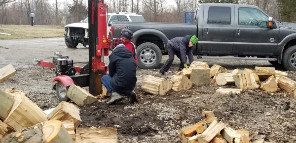

    Well, the kids seemed happy with the faster cycle times, they ran a tank of gas through it. Tried flipping the shaft on the control lever, but it still won't hold in return position. Still have to change hydraulic filter and fluid before I tinker with that more. Overall very happy. 20190302_161456.jpg
