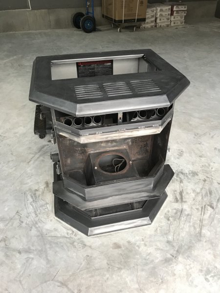

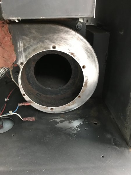

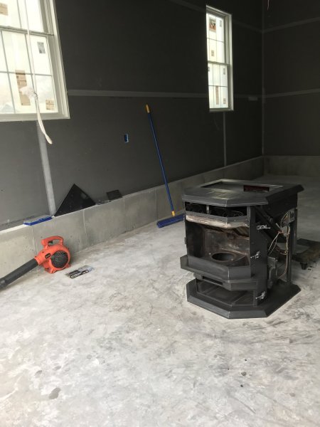

    Making some progress. When I brought the stove home last week I actually cleaned it and stripped it in the back of my box truck because nobody was available to help me get it out of the truck. Im planning on painting the stove but with the cold weather coming in I can do it outside and can’t do it inside. So the stove came to work with me on Monday. Im a plasterer and just started on a new house. Nice big garage for me to do my thing. So while I’ve been busy spreading plaster I’ve had my helper sanding the stove whenever he has downtime. He went to town on it. Gave it another labotamy with a leaf blower then compressor and wiped it all down with acetone. Here she is ready for paint

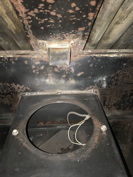

    When i took the pot out there was just about nothing left of the gasket. On that note,is this the procedure for changing the igniter every time. Seems like a lot of work to get the igniter out and I’d assume I’d have to change the burn pot gasket at the same the

    I’ll have to check that out. Manual makes it sound so easy but I couldn’t get it out until I loosened the pot. Sliding it to the right the wires were hitting the wall with probably 1/4 of the igniter still in the holder. I didn’t want to force anything so just waited till I was pulling the pot. I’ll explore more on reassembly if the stove. Gaskets are arriving tomorrow and hope to get it painted this weekend

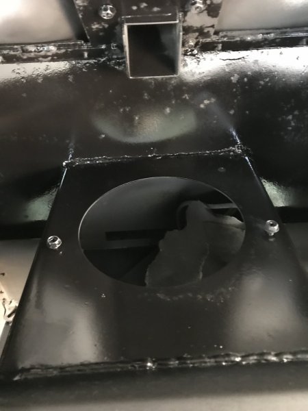

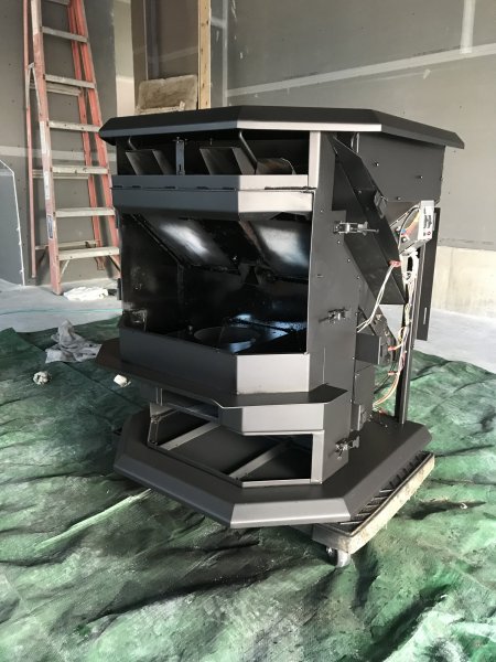

    Today was a productive day. Got the firebox done with 3 coats of VHT paint and 2 coats of Stove Bright black satin on the body of the stove. I still have the door to do and the side panels but other than that she’s good to go.now I can at least get it out of the builders house and into my basement. Hope to move it Monday

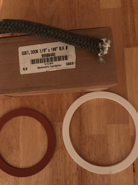

    Gaskets are ready to go. Burnpot,combustion and door gaskets
