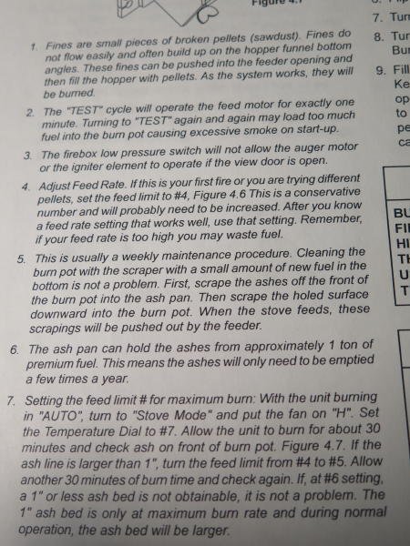

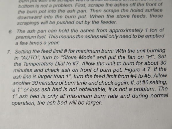

    Aren't you really supposed to adjust that feed rate setting in regards to that one inch of ash? I am not a Harman owner so I am not 100% sure, but I feel like I have read that manual says you are supposed to adjust that as needed to maintain that 1".

    No need to worry about the 1" ash line , here's what the manual says .

    yep...
    don't get too attached to the 1" ash line
    it's not a deal breaker concerning your Harman burning correctly..
    feed rate #4 is the more important setting..
    many of us don't fret about the ash line cause at 4 it will be close enough..
    deffinitly need the probe for running room temp mode.
    some older harman circuit boards call for feed rate #3....
    it will say so inside the control door....mine sez feed rate 3 but I usually run it 3.5....

    But what I read is you should adjust it, especially if you need to run it full blast for a period of time. Now number 4 may be good enough for most cases. It still should be adjusted in an ideal world.

    Never had to run mine full blast , everyone situation is different , but as it says in the manual line 4 , that 4 is a starting point conservative adjust from there .
