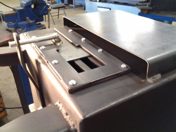

    To answer your questions Dexter , both the primary and secondary air slots are in the back and both controlled with a slide gate with a simple lever in the front. The stove top always runs between 550 and 700 so, if you're just simmering or warming, ya gotta use a trivet. I want to get a couple burned out with different designs - I think they would make nice accessories or promo add-ons. It's difficult to get lower temps. aircontrol.jpg

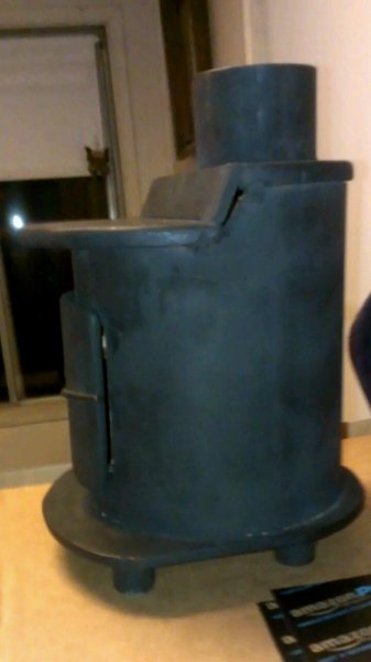

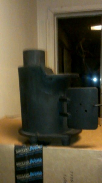

    Oh , I forgot I wanted to share this with you folk my first tiny homemade stove... I think it's really cool!! Yes it is really small & that's why I'm not using it.... Short burn time. I thought youd get a kick out of it...!!

    Small but heavy...

    That pretty cool, would go great in my boat. Seal up thos air leaks along top right side, and put air control on the air holes below the firebox and I bet you will get 24 hour burns!! ;)

    Small but really cute....:)
