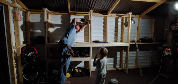

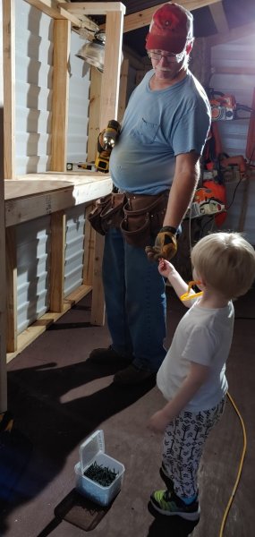

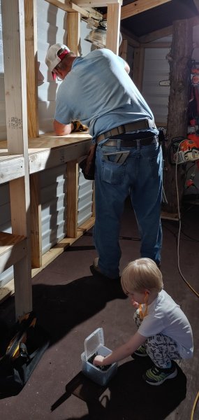

    Working on moving more tools to the new shed. The little shelf just won't do. Designing places to fit what we have. Still have more to do. Had some great help the other evening too.

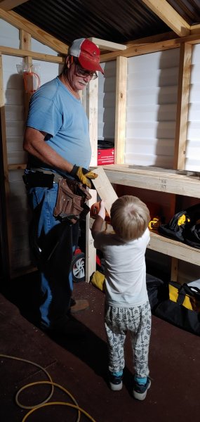

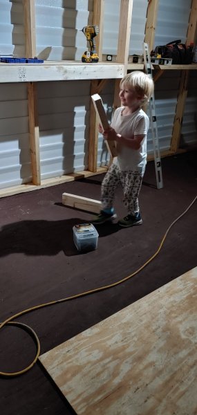

    3 yr old, RJ was my little right hand man. 0513202035_HDR.jpg 0513202036b_HDR.jpg He's a great board otter too. 0513202048_HDR.jpg 0513202051.jpg

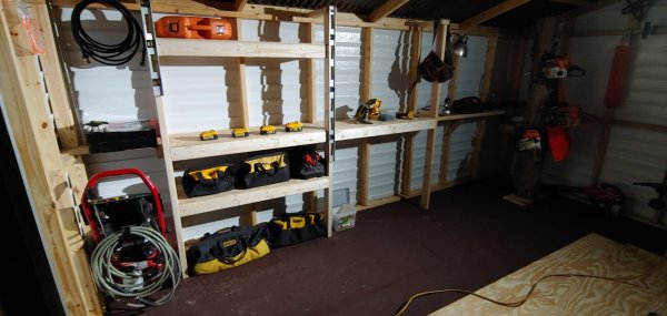

    Pressure washer area first, then battery tool storage. Shelf with the batteries on it will be the charging stations when I get it wired. Got to add more shelves to the next section, part of it will be used fastner storage ( screws and nails). Probably build more for the right side too. 0513202140.jpg

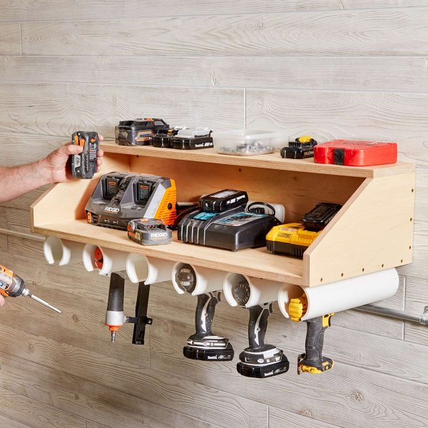

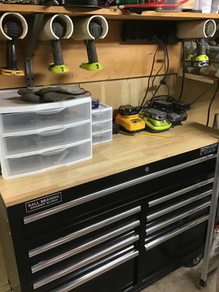

    Great job on the new shed. Been doing similar things with my old shed and garage.
    Made a nice storage area for cordless drivers and drills.
    Based on pic I saw online

    Thanks. I like the drill/driver holders. I have some big PVC pipe. I may make some like that, easier than digging them out of the bag every time.

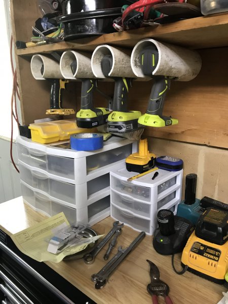

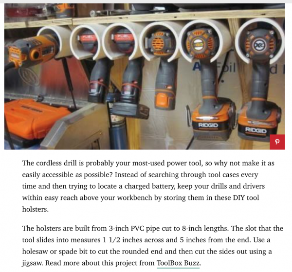

    Here are the pics I started with. Note the air nailer stored too.

    Thanks, more great ideas

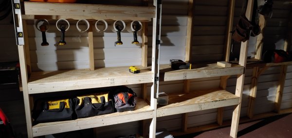

    Well, by the time I got home with supper and we ate, no time to CSS farwood, so we worked on the storage building. Thanks for the idea mikeward , I made ours with 4"PVC I had on hand, and made another shelf 0516202213.jpg

    Looks awesome!
    I leave the drive bits in mine. Saves time looking for em.
    I had to find a slightly larger tube for my 1/2" impact driver. It was just a little thicker in the body.
