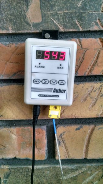

    Todd, you're not monitoring cat temp this year?

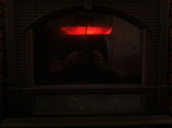

    I installed a DuraFoil SS cat last Dec. It works much better than my original SS cat ever did IMHO.

    Not yet, my cat probe only lasted one year so I'm a little Leary of buying another.

    Wow, that thing is really glowing, does that kind last longer?

    It glows all the time. Well, not all the time but it glows a lot. If it's glowing you know it's working, but it is often working great with no glow as per my cat probe, WS ,BKVP and others. I'm sure your Princess insert cat glowed often, the Keystone just gives a nice cat view from the recliner.

    Last longer? I don't know but I think the technology is moving forward.

    What happened to it?

    Maybe it melted! o_O But seriously, yeah, it should have lasted longer than a year I would think. Heck, I'm pretty sure the probe in the Buck 91 is 5 yo or more and still works well. I think Todd had the probe bent around the shield...or was that his previous setup?

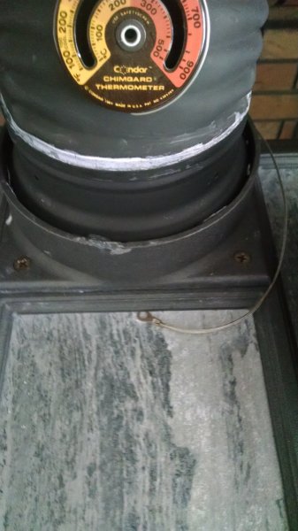

    It was a Auber 10" thermocouple probe that was inserted into the cat probe hole in the back of the stove. When I fired up the stove the first couple times this year it was reading hundreds of degrees low and if I wiggled the wire it jumped all over the place. Maybe there was a short or break in the wire?
    After last years data from the cat probe I'm pretty confident what the cat temps are just by looking at the surface temps and the glow. Usually they were just over double the stove top temp. I don't think I ever went over 1600 CT even with a 700 STT.
