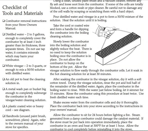

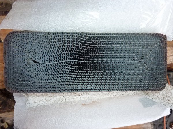

    I believe the first generation was what's referred to as "diesel foil" and were the ones that some folks had trouble with. I didn't have any trouble with them, but two of my SILs shriveled theirs because their stoves leaked air and the cats were no doubt very hot from flame and high cat temps due to uncontrolled off-gassing. One diesel foil is in the Fireview I sold to my BIL. That one is in its third year...I'll have to check out how it's working when I'm over there some time. I have a diesel foil in my Dutchwest and it's broken in now. I can still easily light it off with only 300 on the cat probe. I think the new Woodstock cats are "DuraFoil" and are heavier-duty. Probably won't shrivel. and may be superior in other ways as well. Can't wait to try one of the Duras, but don't need a cat right now. I don't think I'll mess with the ceramics from now on but like Todd said, the jury is still out over the long haul...
    IIRC, cardboard is one of the things not to be burned. I'm guessing some chemicals in it could poison the catalyst metals, as opposed to just masking them, as Todd referred to with the potassium. Masking can be removed by vinegar/water, poisoning is irreversible.
    I have to believe that simmering the cat out would clean it best, as opposed to spraying, but I could be wrong. I'm trying to simmer mine out every other year, but every year would probably be better... Page 6 details the white vinegar/distilled water cleaning procedure: http://www.condar.com/combustorcleaningmanual.pdf
    The article Todd linked said that cat effectiveness didn't drop much even after 8 yrs but I'm thinking this is after the cat is lit. If it takes higher temps and a longer time to light the older cat, then it is indeed less efficient.
    It is probably that the smoke is moving through the cat too fast to be burned. It lacks Time, one of the 3 Ts required for the cat to work...Temp, Turbulence and Time. If I open up the air on my cat stoves and have flame in the box, I go outside and see smoke from the stack. That's why hybrids look to me like the ultimate; You can burn clean at high or low burn rates. I don't know if I can stand the wait before I can get the Woodstock 211 on the hearth... :cool: :smoke::yes: :drool:

  4. bogydave
    Thanks
    Will try this for the annual cleaning.Made it a jpg

  18. bogydave
    One of m theories was they are going to get more expensive year to year.
    Save a few bucks now, thought $30 shipping was reasonable.
    Will clean it more often & try to get 3 - 5 years out of it.
    Old one still glows, just not light off as fast or maintain the heat on low burns,
    new one glows bright during low burns where the old one did not.
