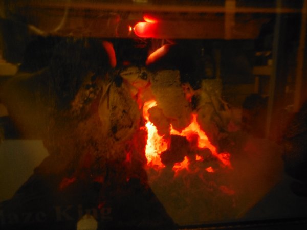

  5. bogydave
    37,220
    When I cleaned the old one , 2 weeks ago, after blowing & vacuuming it, I soaked it in distilled vinegar.
    I notice an improvement.
    I'm in the camp that, like most equipment, some maintenance can extend it's efficiency.
    But 10 years, of 7 to 8 months of 24/7 burning per year,
    50,000 hours is a long time to maintain peak efficiency . Need to see the data for me to be onboard with that.
    The ceramic ones may hold their efficiency longer.
    Need a good honest multi stove performance test, with SS & ceramic combustors .
    Maybe there's one out there, I haven't found any.
    Every test is with a new combustor, that in it's self, leans toward used combustors are less efficient.
    I think the stove manufacturers know, but are reluctant to come clean with the data.
    Adding a few hundred dollars to general maintenance every few years could swing a consumer
    in another direction. "I'm going with the Catalytic stove that gives a 10 year warranty "
    But, like Todd found out with the 6 year warranty, ( hidden in the fine print: or 10,000 to 12,000 hours)
    Be interesting to see some with several hours over the 12k put in a new cat & give a performance review.
    Mine is a very noticeable performance improvement so far.
    20° this AM, last nights load pic is above.
    This morning house temp is 73, lots of wood left to burn.
    Stove still putting out good heat. No doubt to me, much better than a few days ago at 30° OATs. :)
    12 hours after last nights full load:

  8. bogydave
    37,220
    I did that to the old one a few weeks ago.
    Soaked about an hour,
    I does help.
    Good/Interesting combustor info
    The big difference for me was the heat I get from the new one on the low stat setting.
    It's glowing hot & way higher in the active temp range than the old one at the same setting.
    Gark, Beetle-Kill and papadave like this.
