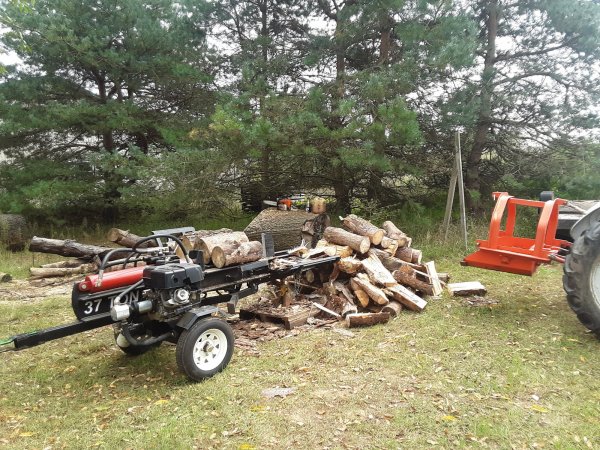

    Got one too, good setup except it needs a hitch on the other end. You have to remove the table to hook/unhook & tow. I put a 2" shim in my 4 way for bigger splits for my boiler. All in all a decent machine for the price.
    Pic of the tongue I put on the other end. I can leave it hooked to the tractor to split this way.
