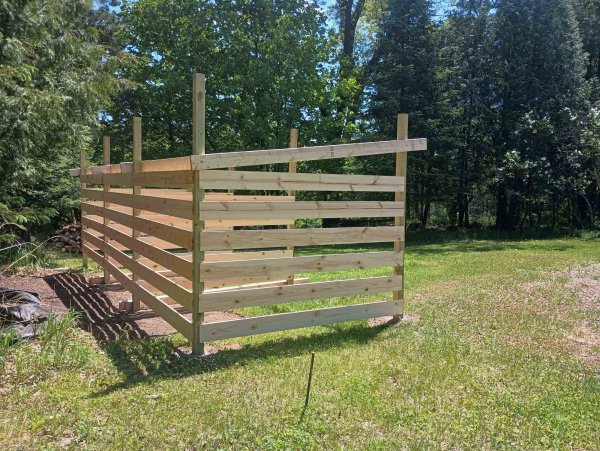

    I built a new shed this spring/summer and happy to have it 2/3 full before winter. Each bay holds enough wood an entire winter, and will have the 3-year plan done when the last bay is full once I split the latest oak tree I fell last week. Had to include a pic of the kiddos making signs on what bay to grab wood from.
    Most of the materials I had laying around, but I did spend about $150 for some of the wood. The tin roof was free; it mostly has no leaks. The few holes it does have are small nail holes that drip occasionally during a rainstorm.

    That size at that height would give you just over 10 cords. You are right, you should double it:handshake::yes:

    I assume your 8 posts are in the ground, is that correct?
    I'm thinking about building a shed like this but I can't decided if I want to sink the posts deep enough to get past the frost line or not put them in the ground and instead buy wood to build 2x6 floor joists, cover those with deck board which then loaded with firewood would be enough weight to hold in down in high winds short of a tornado.
    More wood= more money vs renting an auger and doing that work after having underground utilities checked.
    I'm thinking 10x20 as sheds 200 sq feet or less do not require a permit here. Your 8x24 at 192 is close to the same.

    Our wood stacks are also covered with galvanized roofing and they work very well. However, even though those nail holes are small, I still advise they be plugged. It is a quick and easy job but it does help a lot, especially when some of that wood will be there for a long time.

    I discovered over the weekend I have two more holes to plug in my 3sided tin shed

    As for the roof nail holes, I just dabbed a little glob of silicone over the holes with my finger...problem solved.

    I went 3 feet down with the posts (free use of an earth auger from work) and encased them in concrete, it's not below the frost line we get here, but it's good enough for this shed I thought. I didn't want to put a floor in this shed as I didn't want to replace it in a few years if it would rot or break with the with the weight. So, I put down about 8-inches of 3/4" clear stone with food grade pallets on top (which I get free from my brother-in-law at the cheese factory) and can easily replace those when the bay gets empty. I'm not sure if I needed a permit, as I didn't care too much because you can't see this from the road!
